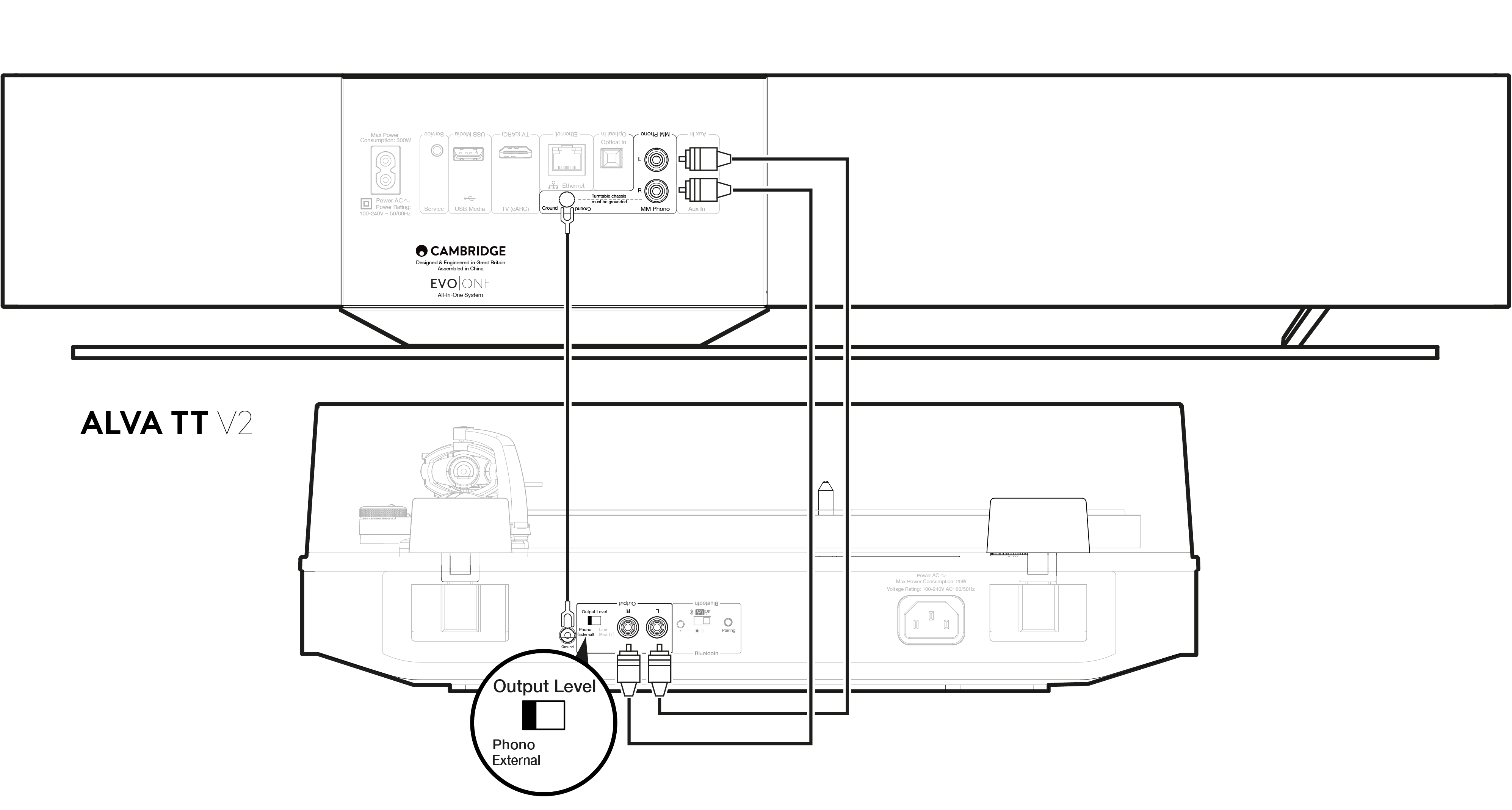

1. Ensure the turntable has been connected to the correct input
If you are connecting a turntable without an integrated phono stage that uses a moving magnet cartridge, please ensure this is connected to the Evo One's MM Phono input.
If you are connecting a turntable with an integrated phono stage, please ensure that you do not connect it to the MM Phono input, and instead connect it to the Aux input.
2. If you are connecting to the MM Phono input, ensure that the turntable ground is connected to the ground tab of the EVO One
This is shown below:
