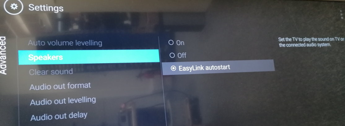

4. Make sure the relevant external sound system is enabled on your TV's settings menu
The above image is an example of a Philips TV running an Android system.
In this case, 'EasyLink' is the name used by Philips to indicate HDMI CEC. If this setting is not 'EasyLink autostart', then the Evo One or any other HDMI ARC/eARC device will not receive audio.
Similar settings may be found with other brands and models of TVs as well, but with alternative naming.
We would recommend checking the manual of your TV or contacting the manufacturer of your TV for more information on this.
