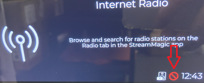

Not necessarily. In many cases, the unit simply hasn't completed its initial setup. To function properly, you must finish the full setup process in the StreamMagic app immediately after connecting your unit to the network, regardless of whether you're using LAN or Wi-Fi.
If you had not done this, you would notice that the network player won’t connect to the network (see screenshot below), and you would need to begin network setup mode again. Once it is connected to the network once more, you need to finish the setup in the app for it to function properly.

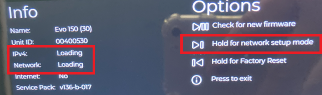

How to Reconnect Your Network Player.
For CXN100, EXN100, Evo One, Evo 75/150 and similar models with an “i” button:
Press and hold the “i” button on the front panel.
1. Press and hold the “i” button on the front panel until the info screen is shown.
2. Follow the instructions on the info screen for ''Network setup mode'.
3. Use the StreamMagic app to connect your product to the network
4. Once connected, use the StreamMagic app to complete the setup steps as above.
