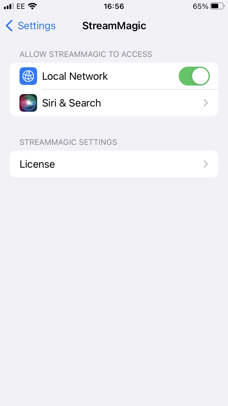

4. Ensure that you have allowed the StreamMagic app to have access to devices on your network, via your mobile devices' app settings.
