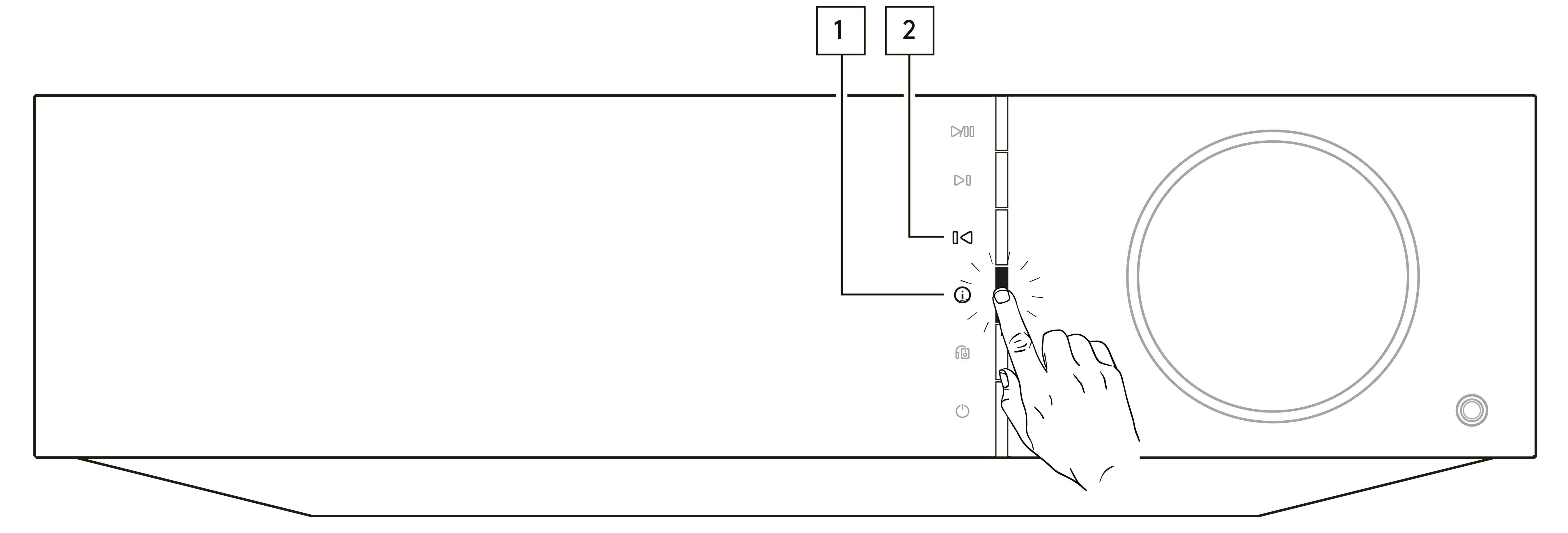

5. Perform a factory reset of the EVO
Please note that a reset will delete all saved settings, presets, and Wifi information.
There are two ways of performing a factory reset on the EVO 75/150.
VIA THE FRONT PANEL OF THE UNIT
Hold down the ‘i’ (Info) button on the front panel of the EVO.
As instructed on the display, hold down the ‘reverse skip’ button to perform the factory reset.
