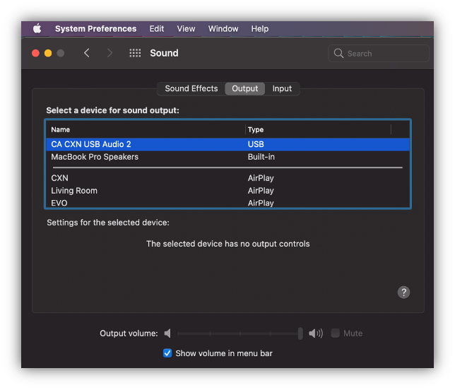

4. Within the System Preferences of the Mac, locate the Sound settings
Select the CA CXN Audio Class 1 / 2 as the output sound device.

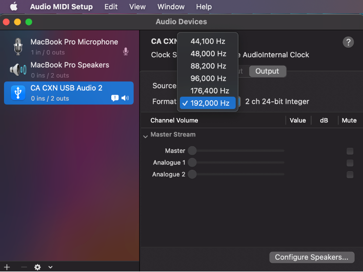

5. On the Mac navigate to Applications > Utilities > Audio MIDI Setup
Select the CA CXN Audio Class 1 / 2 as the output sound device on the left column, and then using the drop-down options select the desired bit depth and sample rate preference.
