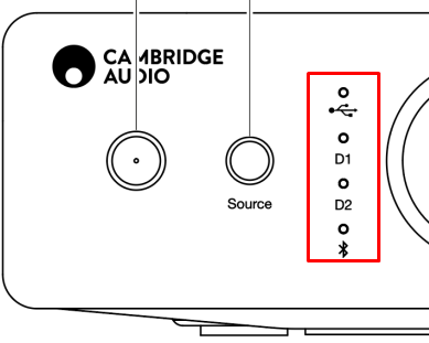

One of the four vertical LED indicators should be lit.

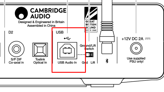

Check the connections of the USB
Make sure that the USB cable is fully inserted both in your computer and in your DacMagic 200M. Always use a certified cable for USB Audio, preferably one that displays an official mark. If you are using USB 2.0, the cable should be "Hi-Speed USB" certified.

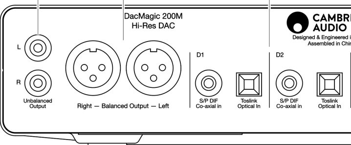

Check the connections of the audio source
Make sure the plugs are fully inserted into their sockets. For digital sources other than PCs/Macs you should connect to SPDIF1, SPDIF2 or TOSLINK.
