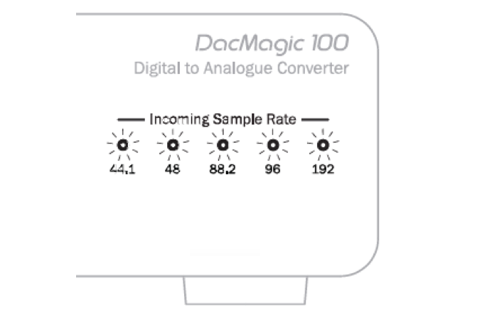

One of the five horizontal LED indicators should be lit, indicating the digital sampling rate.
Note:
For 32kHz no LED will be lit, but the DacMagic 100 will still operate.
