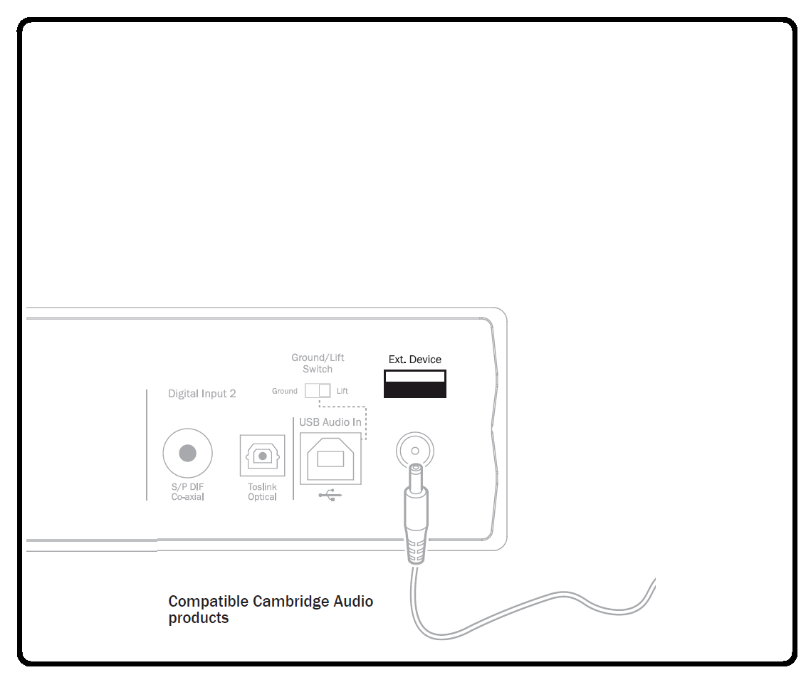

1. Insert the BT100 into the USB port on your compatible Cambridge Audio product
You can insert the BT100 directly onto the "Ext. Device" port or use the BT100 Extension Cable.

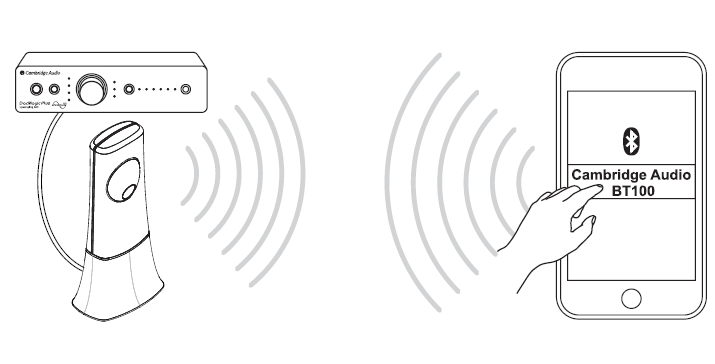

2. Set the BT100 to pairing mode
- Wait a moment for the BT100 to be detected.
- Double-click the button to enter pairing mode.
The BT100 flashes rapidly to indicate it is in pairing mode.

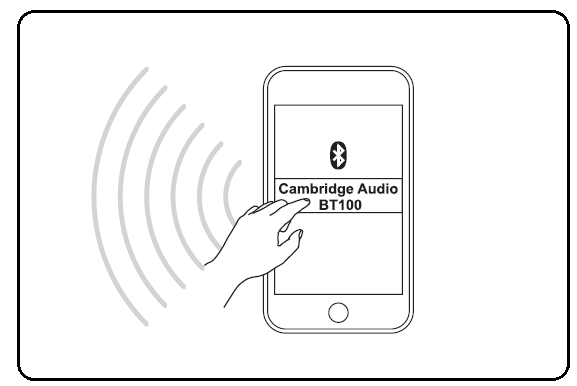

3. Pair to the audio source
- Put your Bluetooth-compliant audio source into pairing mode. Please consult your manufacturer’s user manual on how to do this.
- Normally on your source, you will need to select Bluetooth Pairing and then the BT100 should appear as ‘Cambridge Audio BT100’ in a list of locally found Bluetooth devices.
- Select that item in the list to finish pairing.
