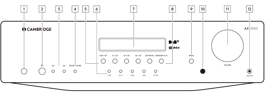

1. Check the correct input source (5) is selected on the front panel
2. Check that the speakers are connected correctly
If using the tuner, check aerial connections and an available station is selected

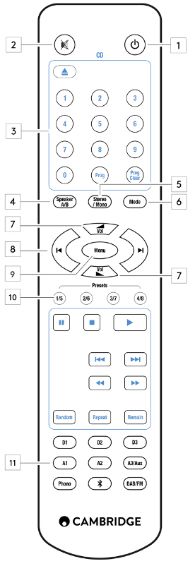

3. Check the unit is not in mute mode
The mute mode can be toggled with the remote (2).
4. Check the Speaker A/B configuration matches your speakers.
