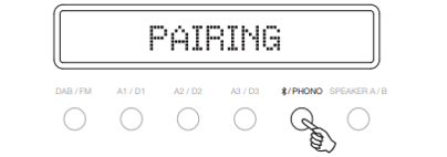

1. Ensure that the Bluetooth source has been selected and the AXR is in ‘Pairing’ mode
Press the Bluetooth/Phono button on the front panel or the Bluetooth button on the remote.
"PAIRING" will show on the display.
