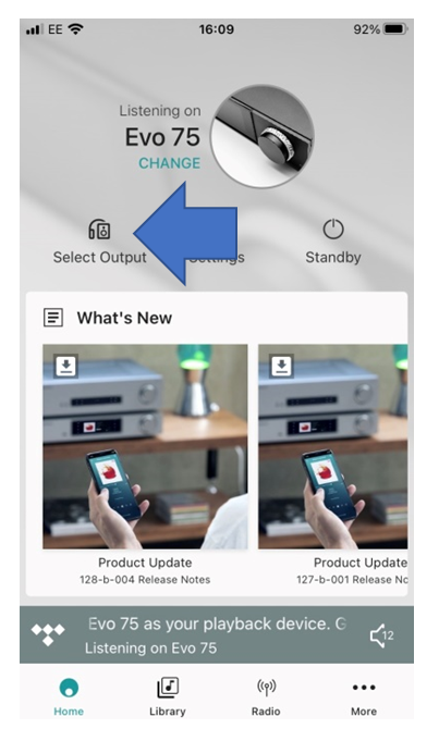

2. Open the StreamMagic app, and ensure that it is on the same network as the EVO and connected to the EVO
3. On the StreamMagic app home page, tap 'Select Output'

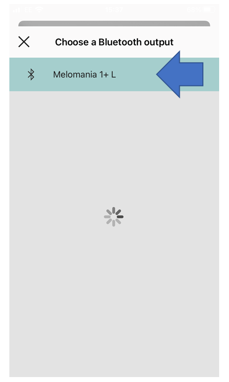

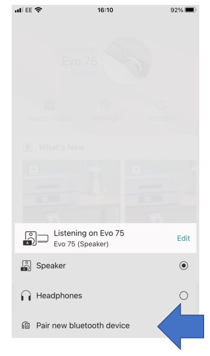

4. Select 'Pair new Bluetooth device'
5. Select your Melomania earbuds / headphones from the list of available devices
