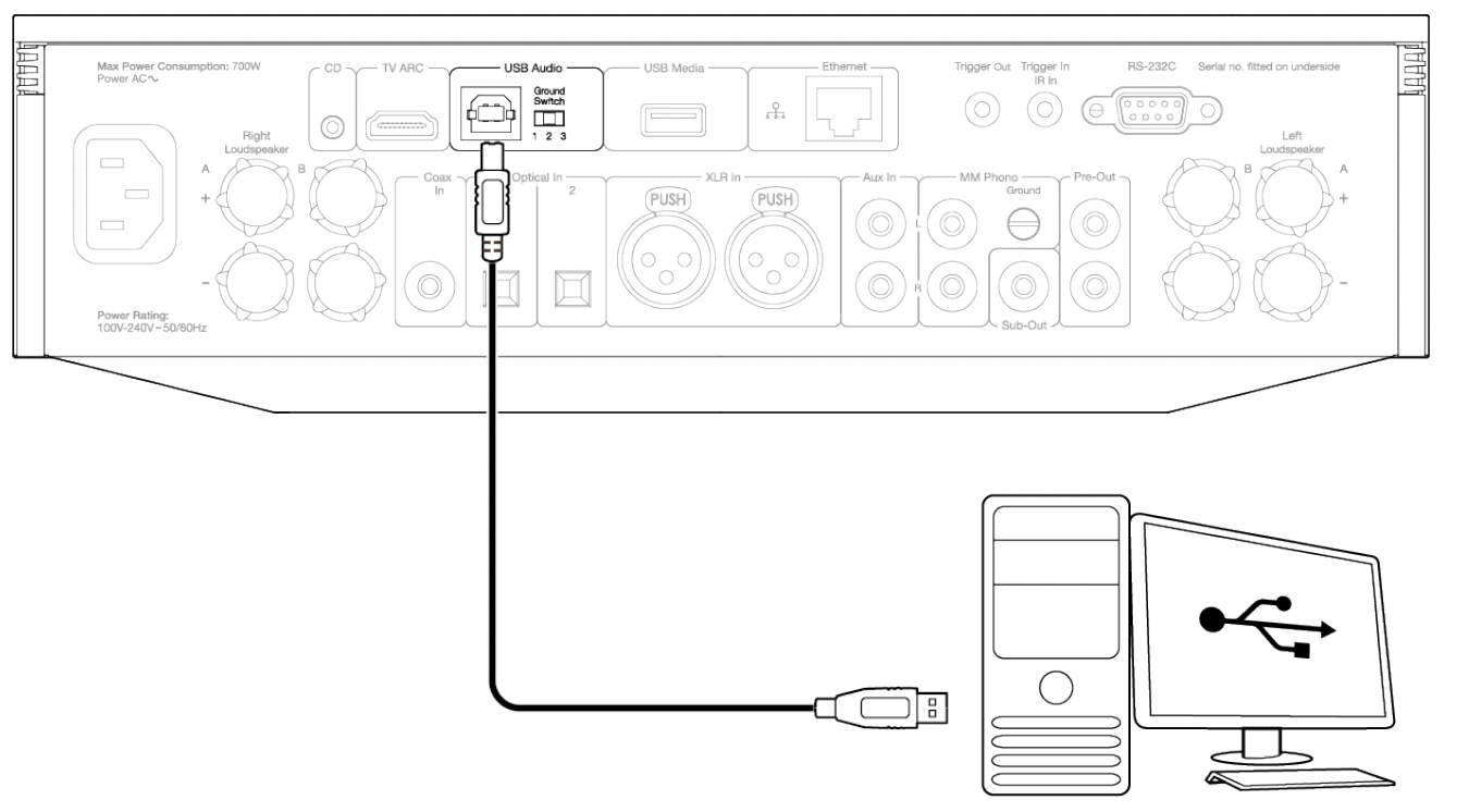

1. Connect your EVO 150 to your Mac
Using a USB Audio cable (Type A to Type B), connect the USB Audio In on your EVO to a USB port on the Mac.
Note: If using a Mac without a USB Type-A port, you may also use a USB Type C (Thunderbolt 3) to USB Type B connection.
