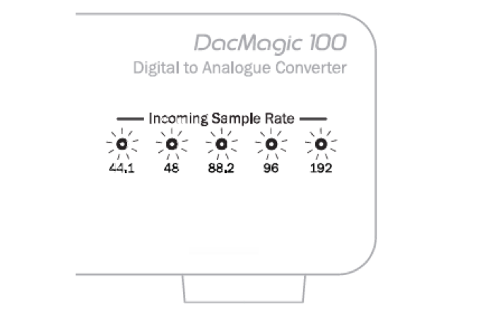

With the corresponding input source selected on the DacMagic 100, the "Incoming Sample Rate" LED lights should be on and will indicate the digital sampling frequency.
NOTE! For 32kHz no LED will be lit, but the DacMagic 100 will still operate.

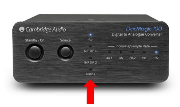

Does the LED indicator display a light indicating which digital source is being used?
One of the four vertical LED indicators should be lit.
