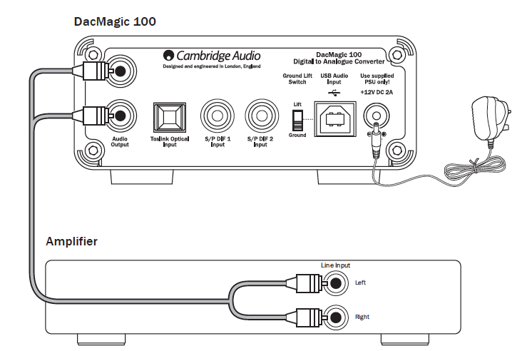

Ensure that the amplifier is set correctly

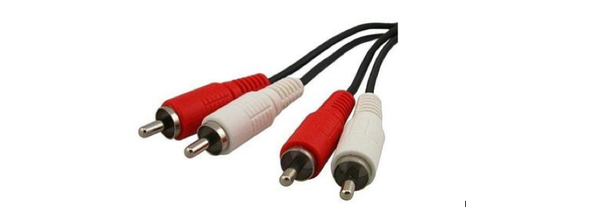

Make sure you are using unbalanced cables (RCA/Phono)
Red tip should go in the amplifier socket marked as "right" and the white tip should go in the amplifier socket marked as "left".

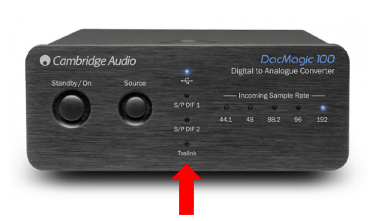

Does the LED indicator display a light indicating which digital source is being used?
One of the four vertical LED indicators should be lit.
