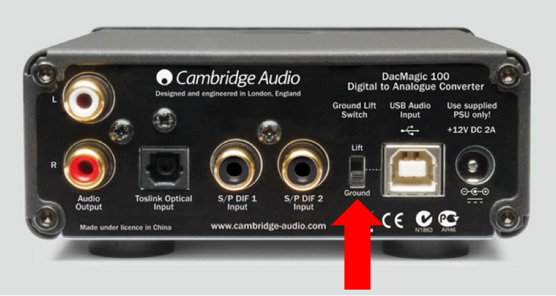

Switch from grounded to lifted
Try to switch from ground to lift using the switch on the back side of your DacMagic 100.
NOTE! It is recommended to use the ground setting unless it causes noise in the audio.
