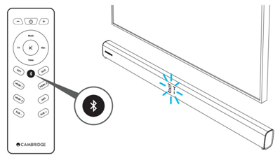

Bluetooth setup:
To connect to the TVB2 via Bluetooth for the first time, please follow the steps below.
1. Press the Bluetooth button on the TVB2 remote. 'BT' will then begin to slowly pulse on the units display as displayed below.
2. Once 'BT' is pulsing, press and hold the Bluetooth button. Once 'BT' begins to pulse more rapidly, the TVB2 is available for Bluetooth connection.
3. You are then able to follow the Bluetooth settings of your chosen device and connect to the bar.
4. Once paired, the bar will display a flashing ‘–‘ symbol until audio from your device is playing.
