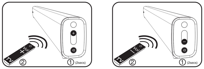

TV Remote: Learning Process
To learn the Vol+ button on your television's remote:
- Press and hold the button on the right side of the TVB2 for 2 seconds. "LEARN" and "VOL +" will flash on the display.
- Then double press the Vol+ button on your television remote, remembering to point it at the TVB2's display.
- After the remote has connected successfully, "OK" will be shown on the display.
- To learn the Vol- button on your television's remote:
- Press and hold the button on the right side of the TVB2 for 2 seconds. "LEARN" and "VOL -" will flash on the display.
- Then double press the Vol- button on your television's remote, remembering to point it at TVB2's display.
