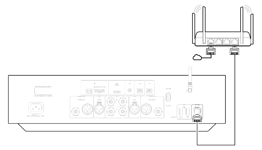

- Connect a network cable (Category 5/5E straight-through Ethernet cable) between the EDGE NQ and your router.
- Your EDGE NQ will now automatically connect to the network.
