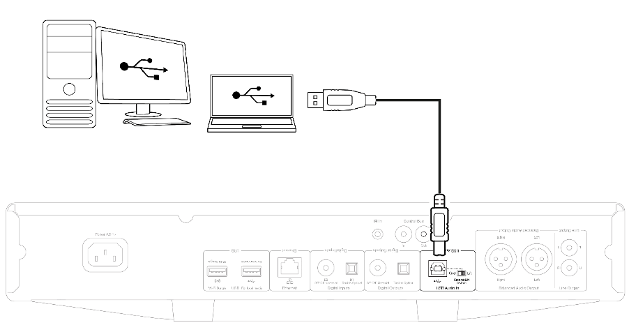

1. Connect your CXN (V2) to your PC
After installing the correct driver, using a USB audio cable (Type A to Type B), connect the USB Audio In on your Network Player to a USB port on the PC.
Note: If using USB Class 1.0, you will be able to playback at a maximum of 24bit / 96kHz. If using USB Class 2.0, you will be able to playback at a maximum of 24bit / 192kHz.

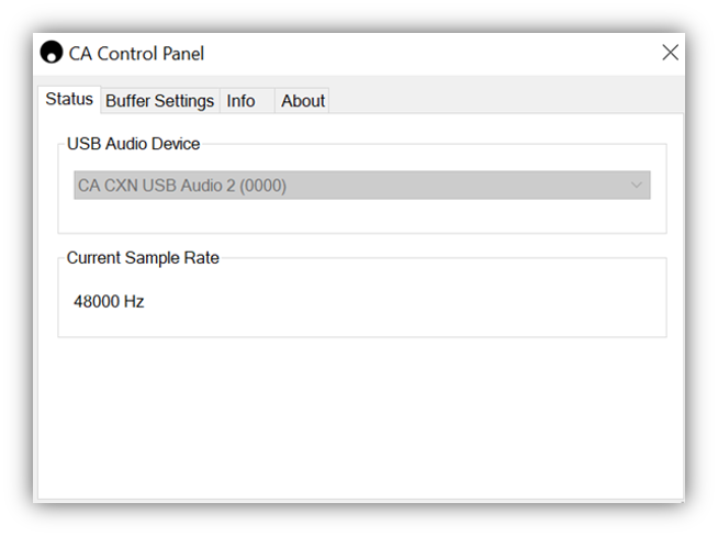

4. Navigate to the CA Control Panel which should now be installed in your Windows taskbar
This will show any connected Cambridge Audio USB Audio device and current sample rate.

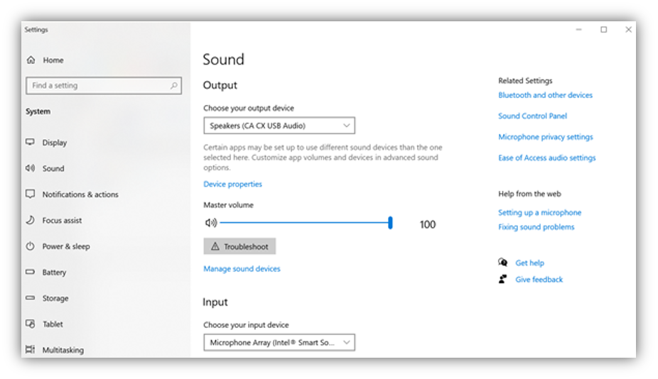

5. On your PC, navigate to Settings > System > Sound. Select the Network Player as your output device from the drop-down menu
This will appear as 'CA CX USB Audio'.

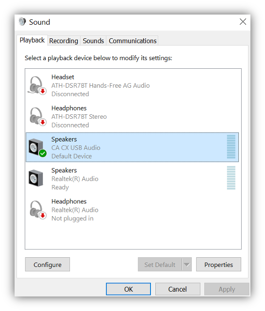

6. Within this same window under Related Settings on the right-hand side, select Sound Control Panel
7. On the Playback tab, ensure that CA CX USB Audio is the default output device, then select Properties
8. Within Speaker Properties, navigate to the Advanced tab. Select the desired bit depth and sample rate preference.
Once selected, select Apply, then OK.
