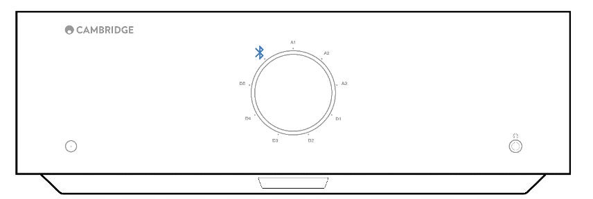

Ensure that the Bluetooth source has been selected via the front panel source selector or the source selector buttons on the remote
Ensure that your Bluetooth device is in pairing mode and not already connected to another Bluetooth unit

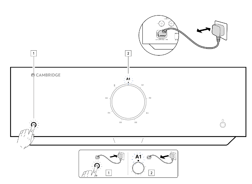

Perform a factory reset on the EDGE A
1. Press and hold the power button on the front of the EDGE A whilst plugging the power cable into the unit.
2. When the A1 input LED starts flashing, disconnect the power cable again to complete the factory reset.
