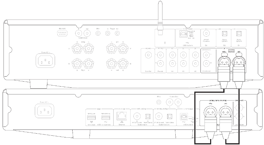

Make sure that the amplifier is properly connected

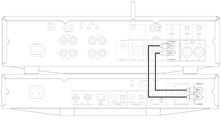

ANALOGUE CONNECTIONS
Basic Analogue Connections
Important Note: Switch the power off before making any connections.
Line Output Connection (RCA)
Balanced Audio Connection (XLR)

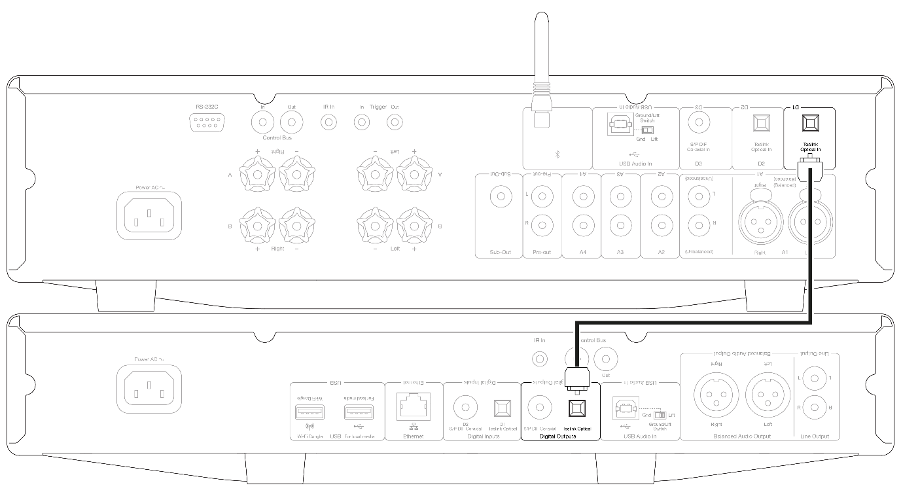

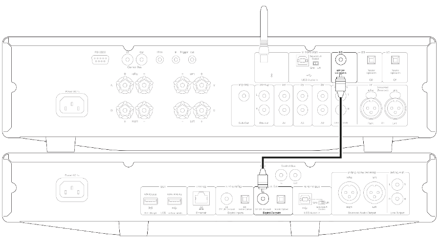

DIGITAL CONNECTIONS
Basic Digital Connections
There are two digital connection options for the Network Player.
Note: If using either of the digital outputs of the Network Player, the digital signal will bypass the DAC in the Network Player and will instead be processed by the unit connected to the digital output, E.g., CXA81
Digital Coaxial Output – Digital Coaxial connections are commonly used with CD players and amplifiers and is recommended for use as it has higher bandwidth.
TOSLINK Optical Output – Whilst having lower bandwidth, TOSLINK Optical connections are commonly found on televisions, DVD players and A/V units.

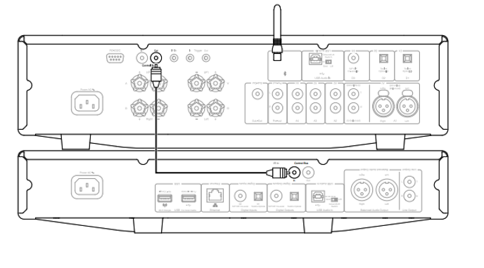

CXN V2 WITH CXA VIA STREAMMAGIC APP
When using the app to turn the CXN (V2) on/off, this will also turn the CXA on/off. The app can also be used to control the volume of the CXA. Connect the CXN (V2) Control Bus Out to CXA Control Bus In.

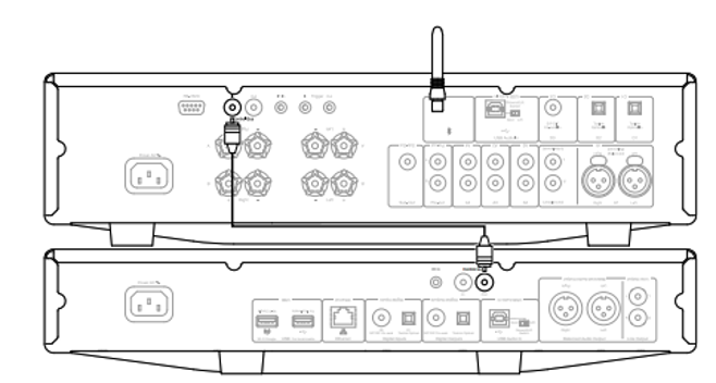

CXA WITH CXN V2
Note: Without using the StreamMagic app to control the CXA.
When turning the CXA on/off, this will also turn the CXN on/off. Connect the CXA Control Bus Out to CXN Control Bus In.

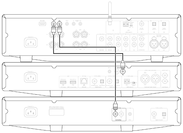

CXA WITH CXN V2 AND CXC
When turning the CXN on/off, this will turn the CXA and CXC on/off.
With all three CX devices, connect the CXN Control Bus out to CXA Control Bus in. Then connect the CXA Control Bus out to CXC Control Bus in.
Note: Do NOT loop back from the CXC Control Bus out to the CXN Control Bus in.
