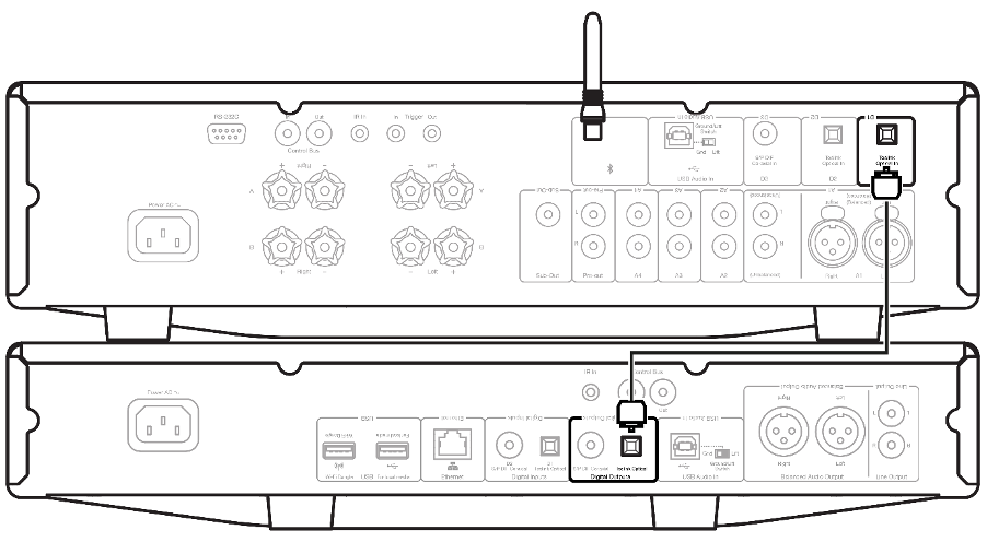

Important Note: Switch the power off before making any connections.
There are two digital connection options for the 851N.
1. Digital Coaxial Output
Digital Coaxial connections are commonly used with CD players and amplifiers and is recommended for use as it has higher bandwidth.
2. TOSLINK Optical Output
Whilst having lower bandwidth, TOSLINK Optical connections are commonly found on televisions, DVD players and A/V units.
