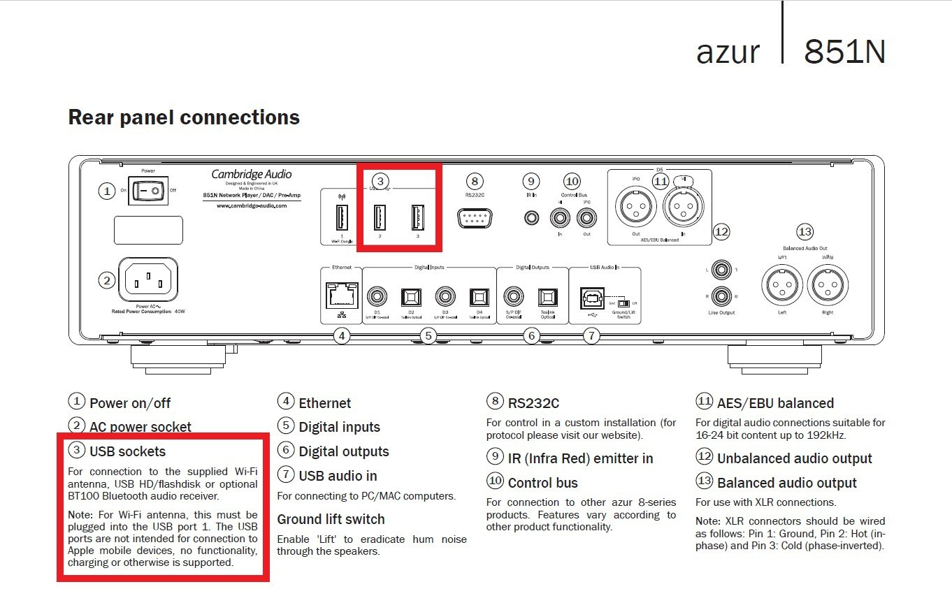

You can connect to the 851N using Bluetooth by using the optional BT100 Bluetooth receiver.
The BT100 is a USB dongle available from our website. BT100
Connect the BT100 to one of the available USB ports on the rear of the 851N
(Please note: The optional Cambridge Audio BT100 Bluetooth dongle can be connected to any available USB socket.)
