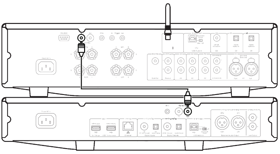

851N WITH 851A VIA STREAMMAGIC APP
When using the app to turn the 851N on/off, this will also turn the 851A on/off. The app can also be used to control the volume of the 851A. Connect the 851N Control Bus Out to the 851A Control Bus In.

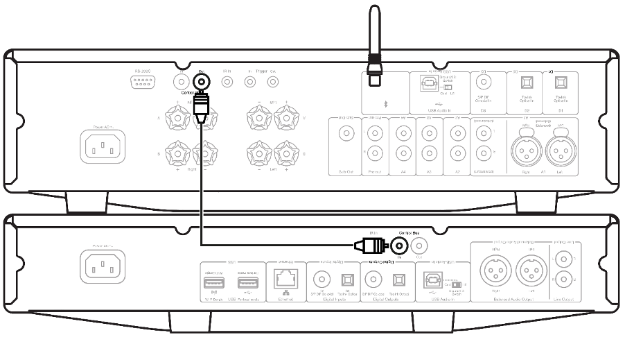

851A WITH 851N
Note: Without using the StreamMagic app to control the 851A.
When turning the 851A on/off, this will also turn the 851N on/off. Connect the 851A Control Bus Out to the 851N Control Bus In.

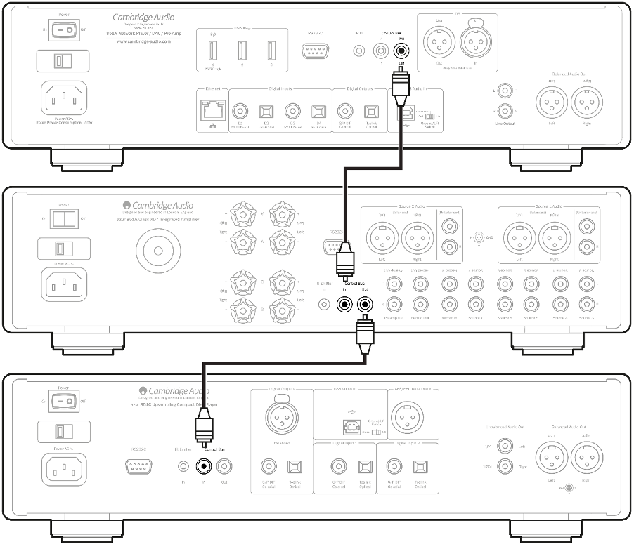

851A WITH 851N AND 851C
When turning the 851N on/off, this will turn the 851A and 851C on/off.
With all three 851 devices, connect the 851N Control Bus out to the 851A Control Bus. Then connect the 851A Control Bus to the 851C Control Bus.
Note: Do NOT loop back from the 851C Control Bus out to the 851N Control Bus in.
