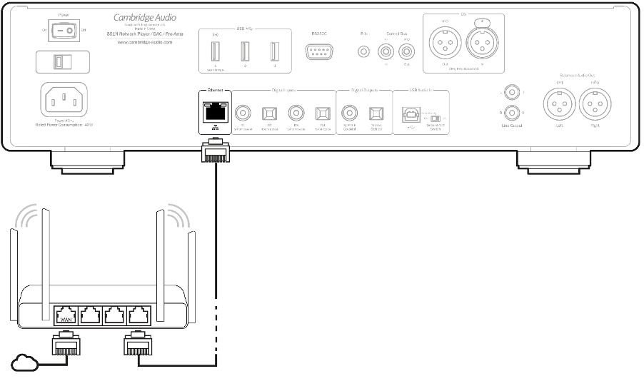

Ensuring the unit is powered down, connect a network cable (Category 5/5E straight-through Ethernet cable) between the 851N and your router.
Your 851N will now automatically connect to the network.
