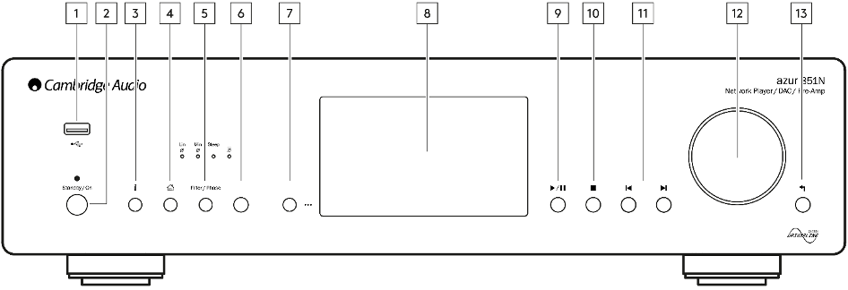

If using the front panel controls of your 851N, navigate to Home > Inputs > USB Audio.

If using the front panel controls of your 851N, navigate to Home > Settings > Audio > USB Audio Class > Then toggle between USB Audio Class 1.0 or 2.0.

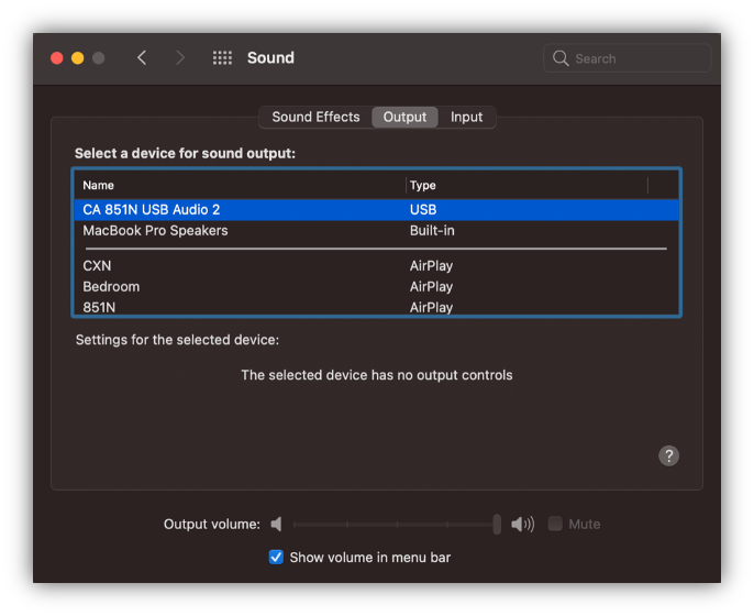

4. Within the System Preferences of the Mac, locate the Sound settings
Select the CA 851N Audio Class 1 / 2 as the output sound device.

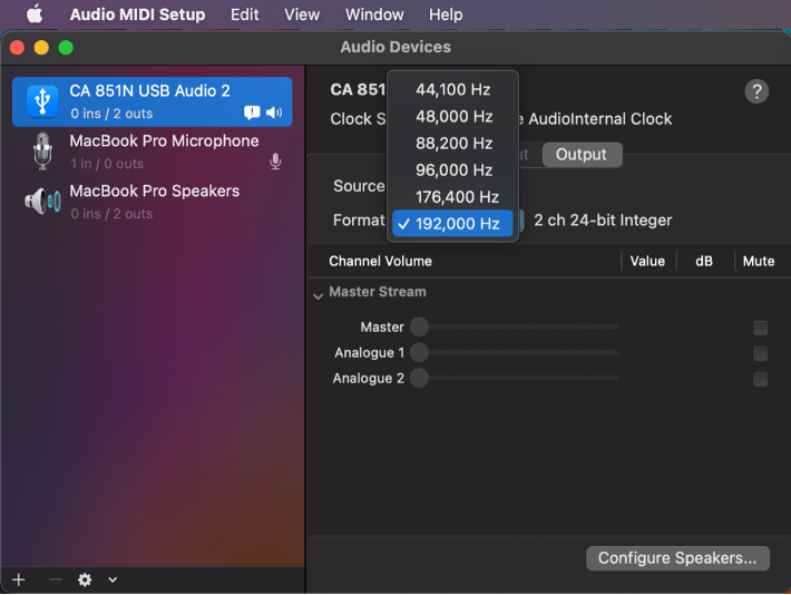

5. On the Mac navigate to Applications > Utilities > Audio MIDI Setup
Select the CA 851N Audio Class 1 / 2 as the output sound device on the left column, and then using the drop-down options select the desired bit depth and sample rate preference.
