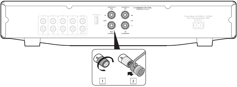

We recommend using Banana plugs with our units to establish a secure connection and ensure there are no loose strands of wire that may cause unwanted noise or interference.
Once you have stripped the outer insulation of the cable and twisted the wires as indicated below, securely connect these to your banana plugs, remove the dust cap from the end of the speaker terminal, and push the plug in as far as possible without applying excessive force.
Note: When using a banana plug, make sure the speaker terminals are completely tightened before inserting the plug.
