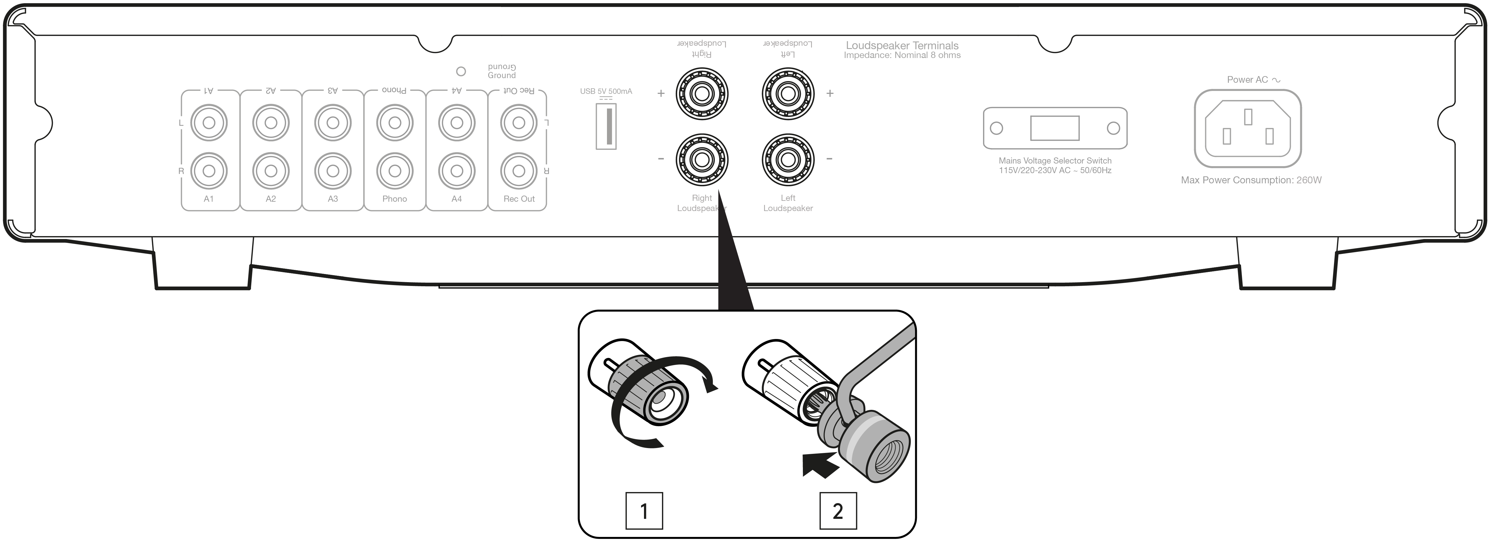

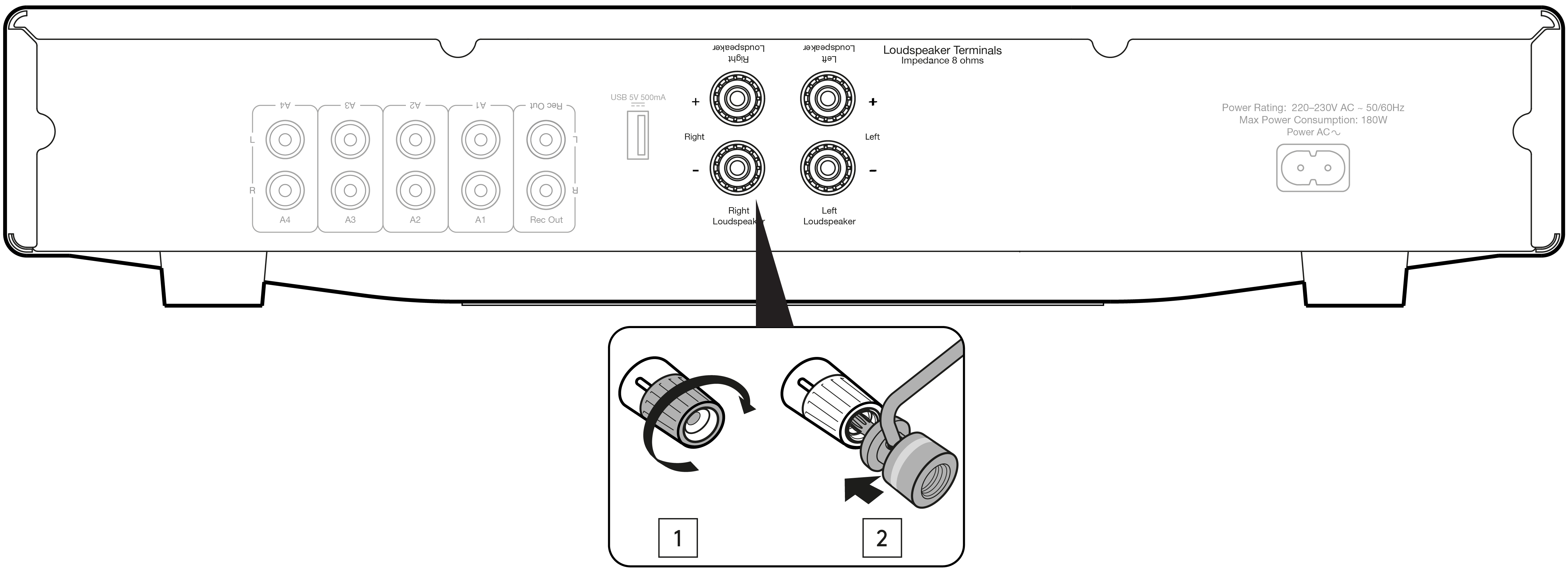

Yes, you can connect banana plugs to the AXA25.
Before doing so, you will need to remove the small round dust caps from the middle of the speaker terminals.
When using a banana plug, make sure the speaker terminals are completely tightened before inserting the plug.
