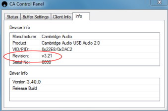

Using this Driver Tool, you will now confirm if the DAC MAGIC 100 requires the update.
Please check the USB firmware Revision in the Info tab of the CA Control
Panel of the driver. It needs to be running firmware Revision v3.26.
If it is running an earlier revision, as in the example below, then your device requires an update.

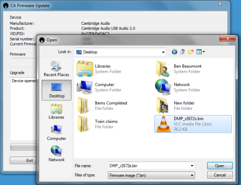

Place this binary file to a known location on your PC, such as the Desktop. - Make sure the device is in USB Audio Class 2 mode, switched on, and connected to your computer.
How do I switch between USB Class 1 and USB Class 2 on a DacMagic Plus.
https://supportarchive.cambridgeaudio.com/hc/en-us/articles/17994074181277-How-do-I-switch-between-USB-Class-1-and-USB-Class-2-on-a-DacMagic-Plus - Go to the TUSBAudioDfu directory in the installer package download.

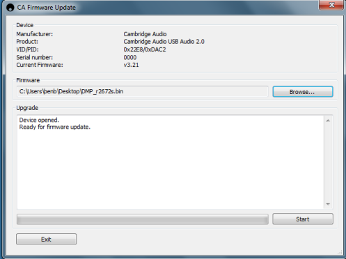

Run the TUSBAudioDfu.exe file - Browse to the .bin upgrade file that you downloaded.
Click on start.

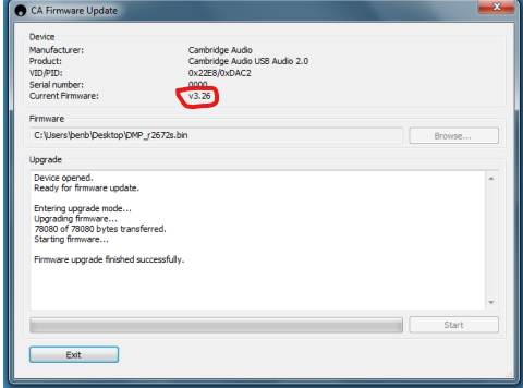

When the upgrade is complete click Exit. - Open the Cambridge Audio Control Panel by clicking on the icon in the task
tray.
Check that the Current Firmware is now v3.26 - The update is now complete!
