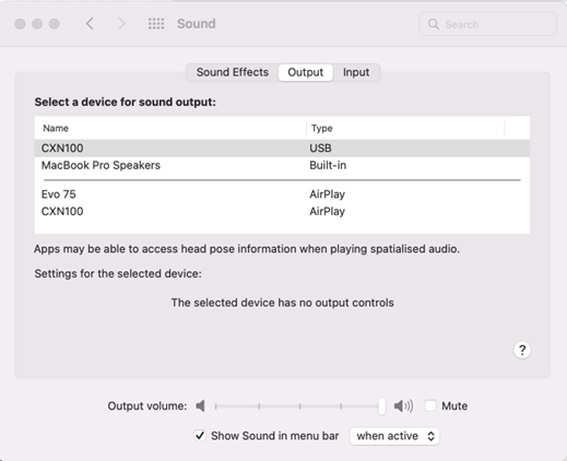

3. Within the System Preferences of the Mac, locate the Sound settings. Select your Network Player as the output sound device.
