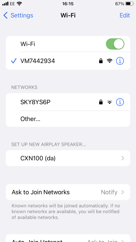

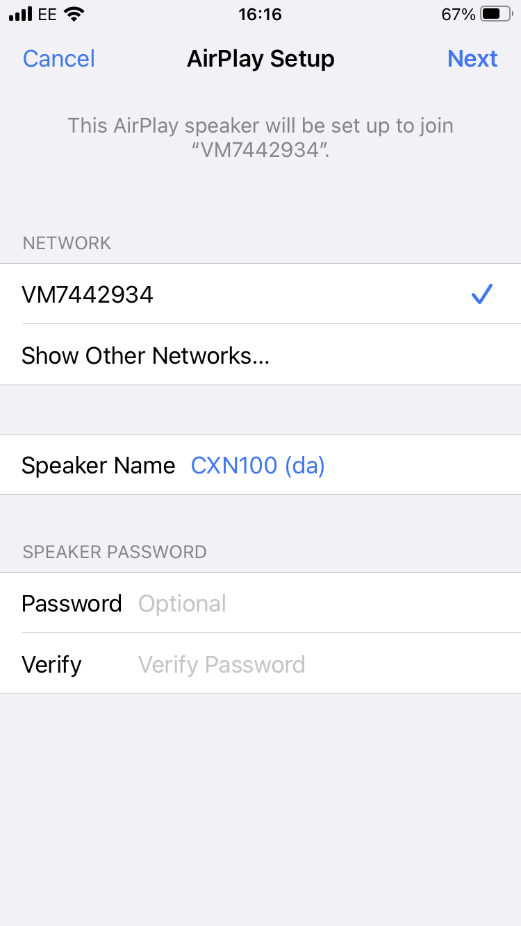

2. Go to the Wi-Fi settings on your iOS device and under ‘SETUP NEW AIRPLAY SPEAKER’
select the name of your Network Player.
Note: Some iOS devices won't show an option for 'AirPlay Speaker'. In this instance still select the name of your Network Player.
3. Once connected, complete unit setup by downloading and installing the StreamMagic app from the Apple App Store
