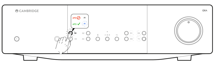

- Enter the setup menu - Whilst the EXA100 is in standby mode, press and hold speaker A/B button until speaker A/B white LED’s flash alternately, then release speaker A/B button.
- Select A1 as described below, to either disable or enable APD.
A1 on (LED will be lit blue) – Sets the APD time to 20 minutes.
A1 off – Disables the APD function.
To save the setup settings and exit the setup menu, press the Speaker A/B button.
Pressing the Standby/On button while in the setup menu will exit this setup menu and will not save the setup settings.
