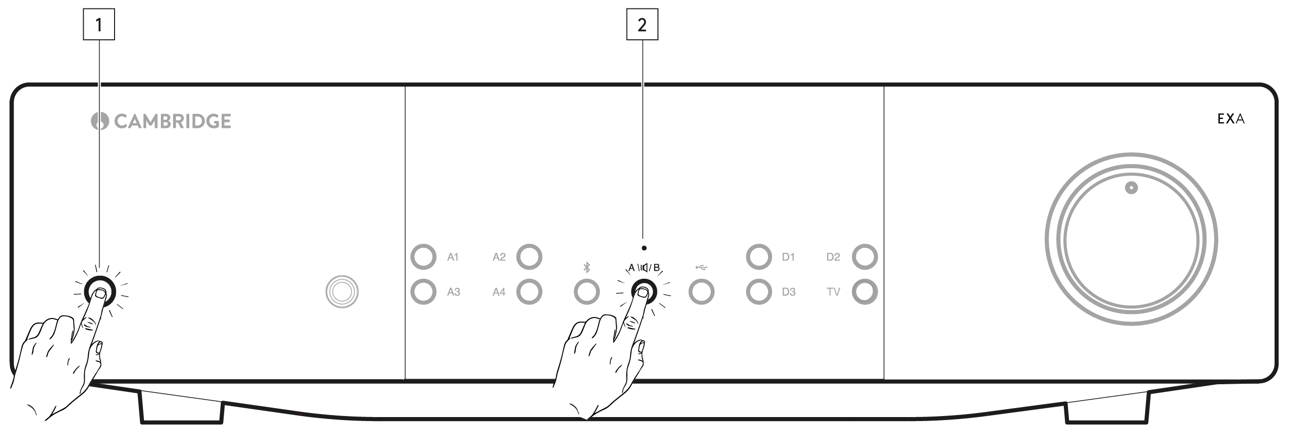

You can enter the Setup Menu on the EXA100 by following the below:
1. Put the EXA100 in standby mode.
2. Whilst in Standby mode, press and hold the Speaker A/B button until the A/B lights flash alternatively and the sources A1-A4 and the TV input LED light up.
Notes:
- The TV input LED indicates that TV Power Control is enabled by default.
- Press the Speaker A/B button once to save any setting changes and leave the Setup menu and place the EXA back into Standby mode.
Pressing the Standby/On button while in the setup menu will exit this setup menu and will not save the setup settings.
