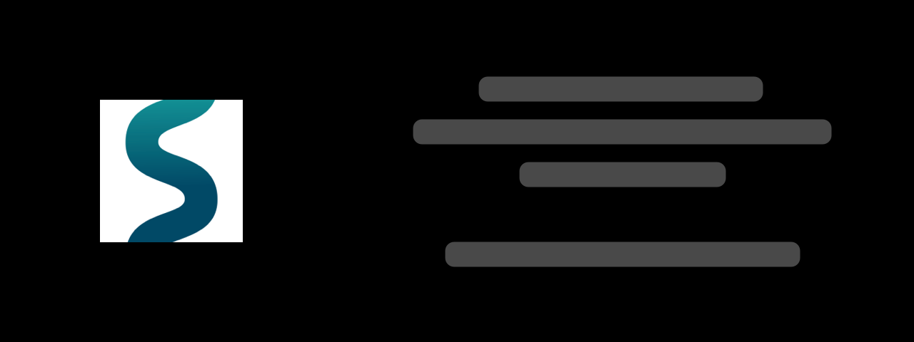

If the screen doesn't look like the one above please carry out the following steps:
- Make sure the unit it switched on

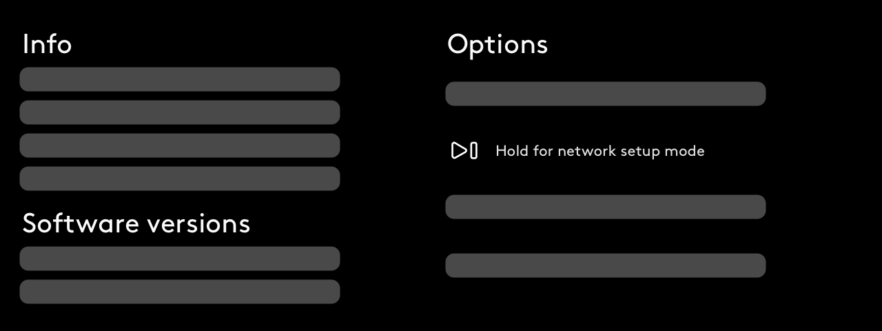

- Hold down the (i) button on the player for a few seconds - this should open the information page
- Press and hold the >| button for 2 seconds to enter into Network setup mode

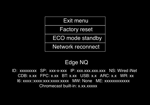

Edge NQ
- Make sure Edge NQ is switched on
- Hold down the power button for a few seconds - this should open up the information page
- Choose 'Network reconnect' with the selector knob
- Confirm your choice by pressing the power button

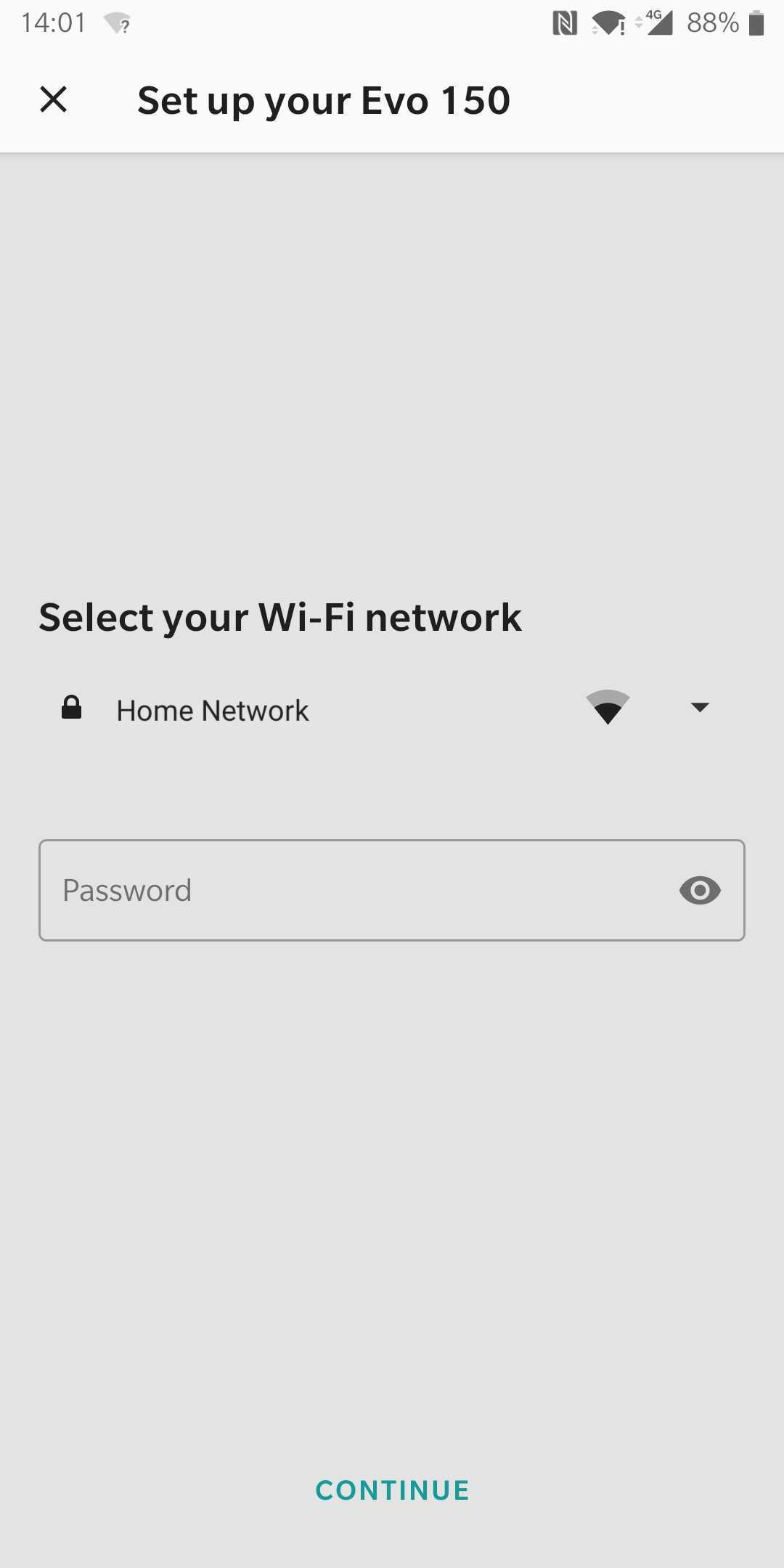

Now that the player is in the correct mode you can follow the instructions in the app to set the player up on your Wi-Fi network.

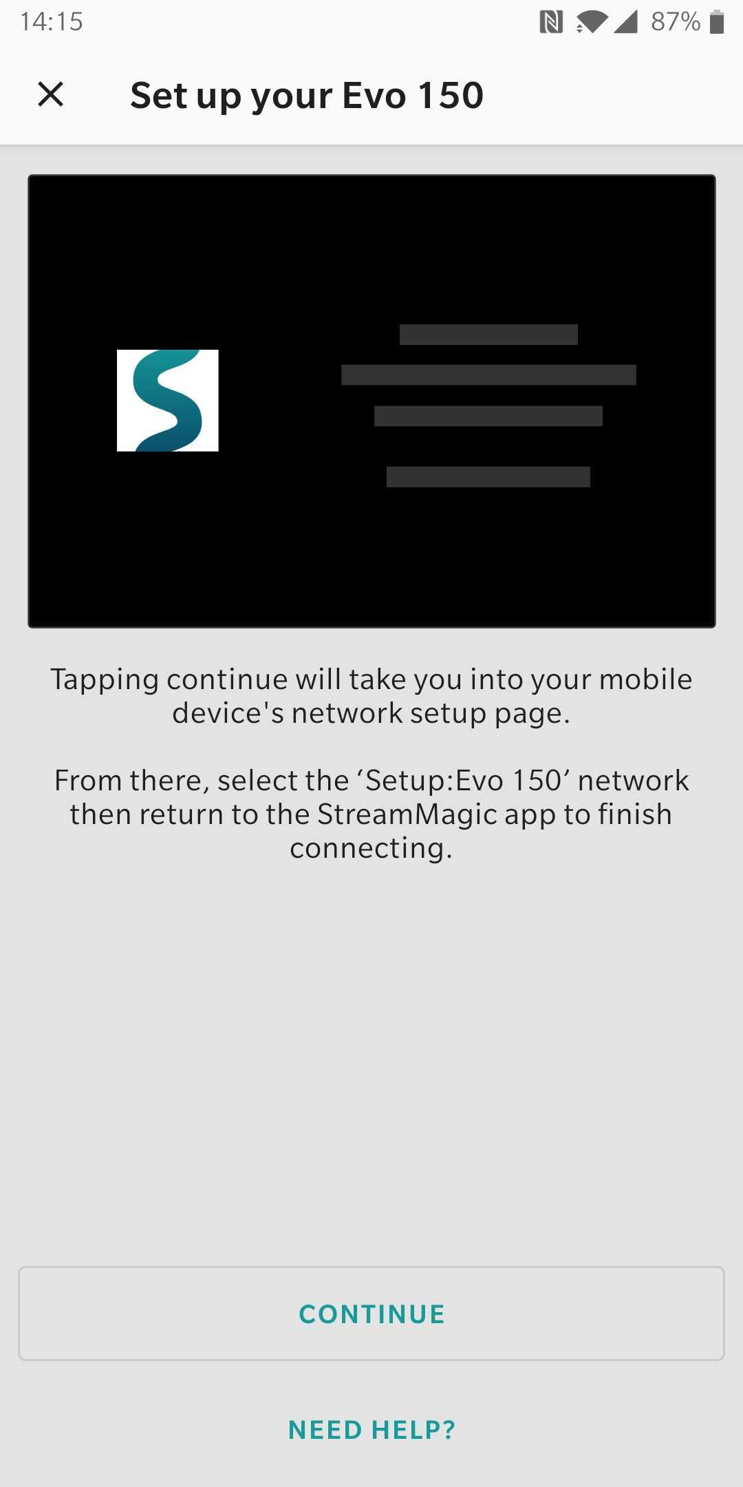

To complete this process you will connect your mobile or tablet to the player's own network, choose your home WiFi network enter the passphrase or code, and then reconnect to your home network before returning to the StreamMagic app.
Follow the instructions in the app to the point where it instructs you to continue to your mobile device settings page.

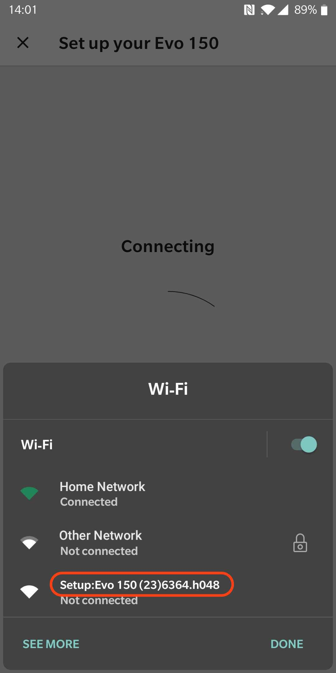

Android 10 and above
Tapping continue will open up your Wi-Fi settings panel over the app.
- Select the network called 'setup:player.in'
- Press Done

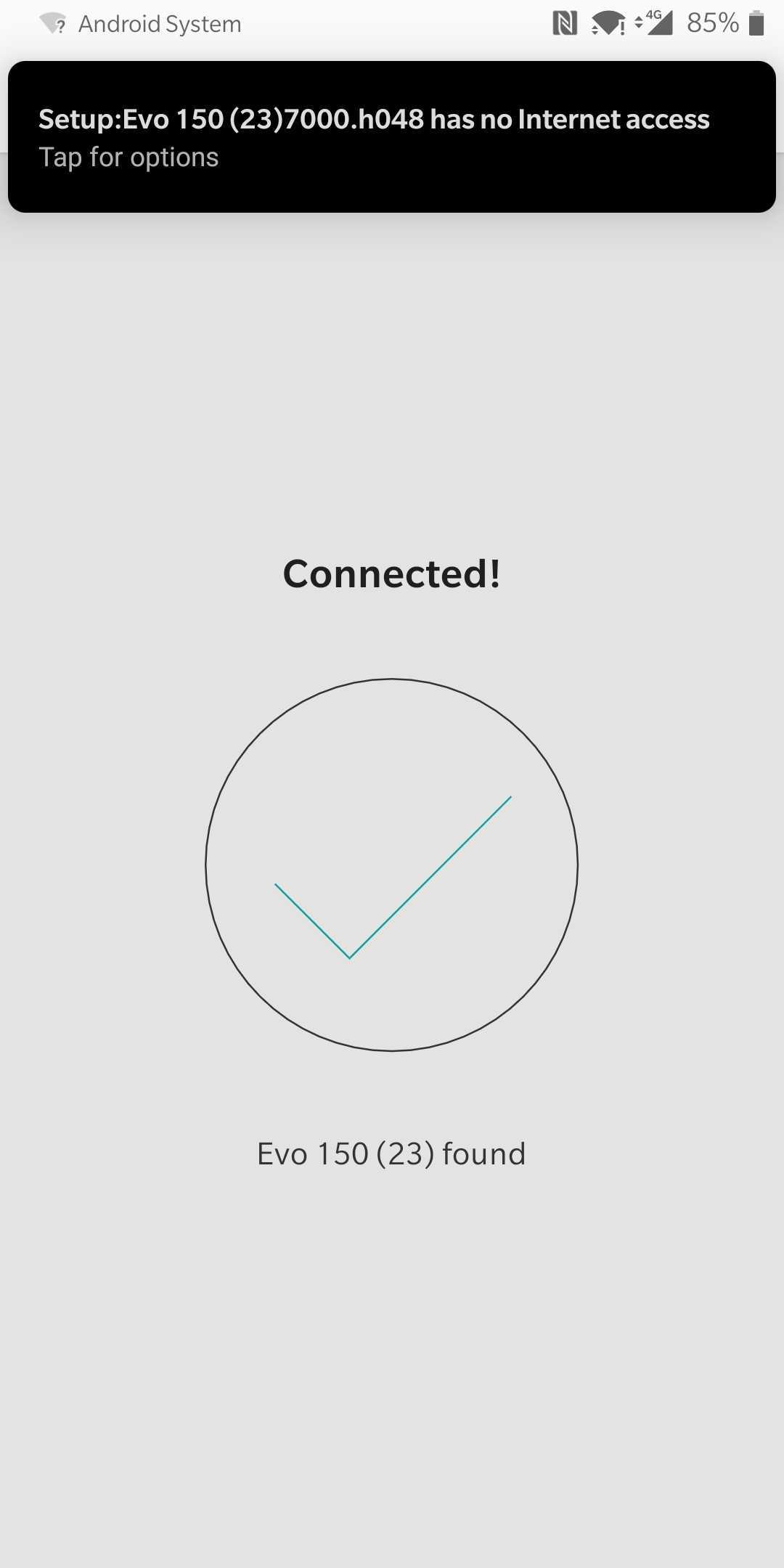

Your mobile device will connect to the player's setup network
Note: Don't worry about any alert suggestions like the one below, remember, you're temporarily connecting directly to your player's set-up network, it won't have internet access until it's successfully connected to your home network.
You'll then be asked to choose your home network and enter your network passphrase or code
Pressing continue will apply the network settings to your player and it will shut down its set up network
