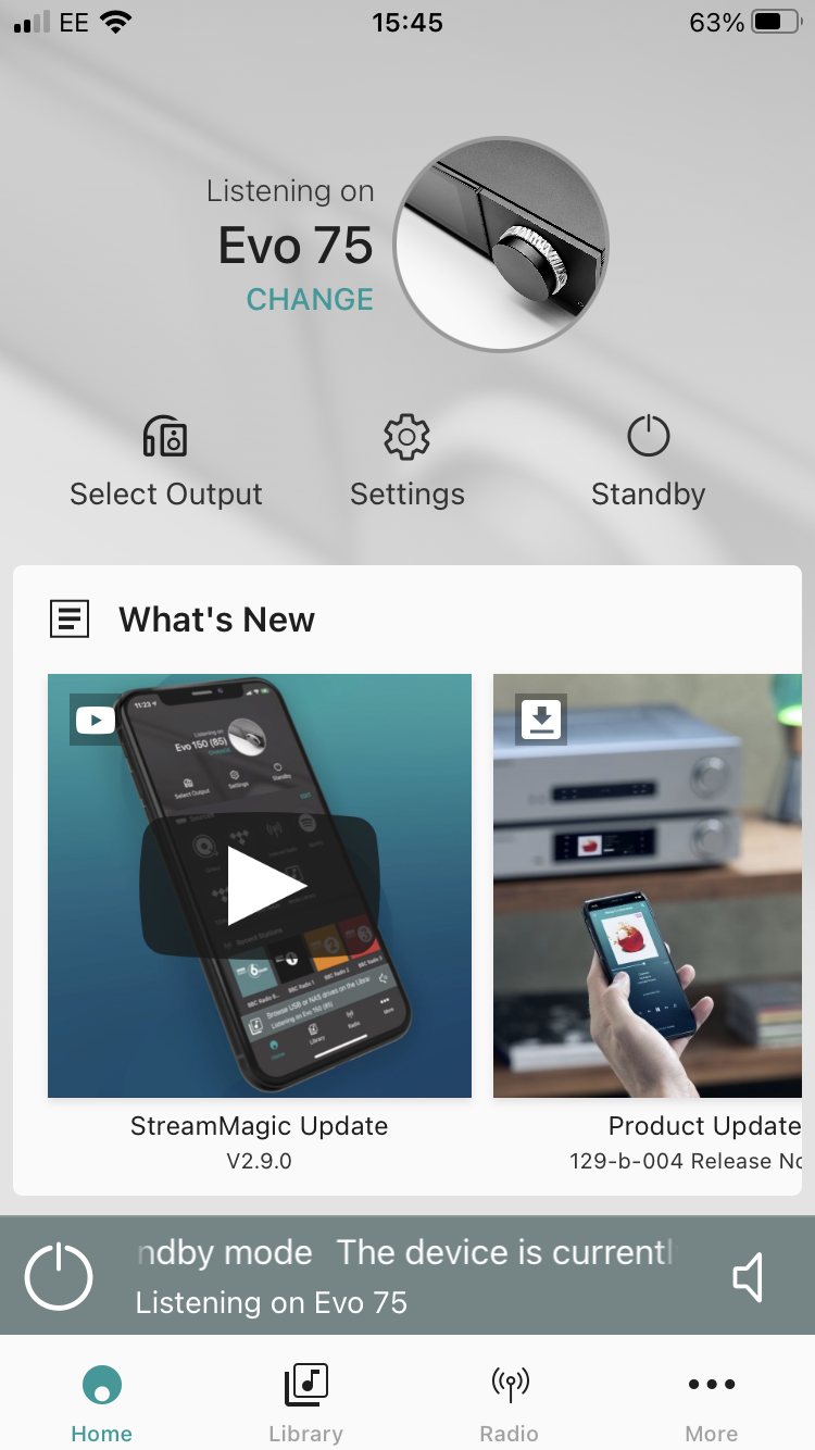

2. Open the StreamMagic app on your device.
3. Ensure that your Network Player is connected to the StreamMagic app.

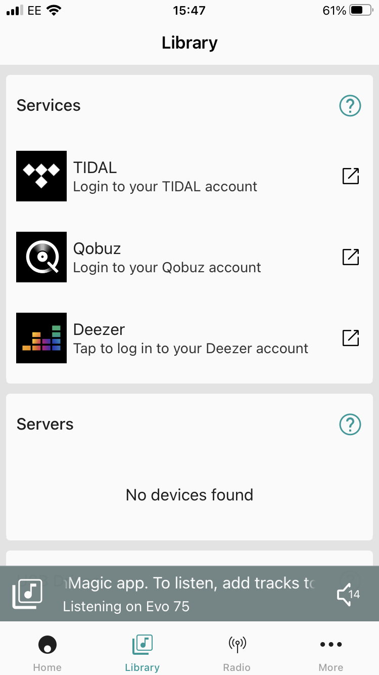

4. Select the 'Library' tab, then select 'Deezer'.
5. Log in to your Deezer account.

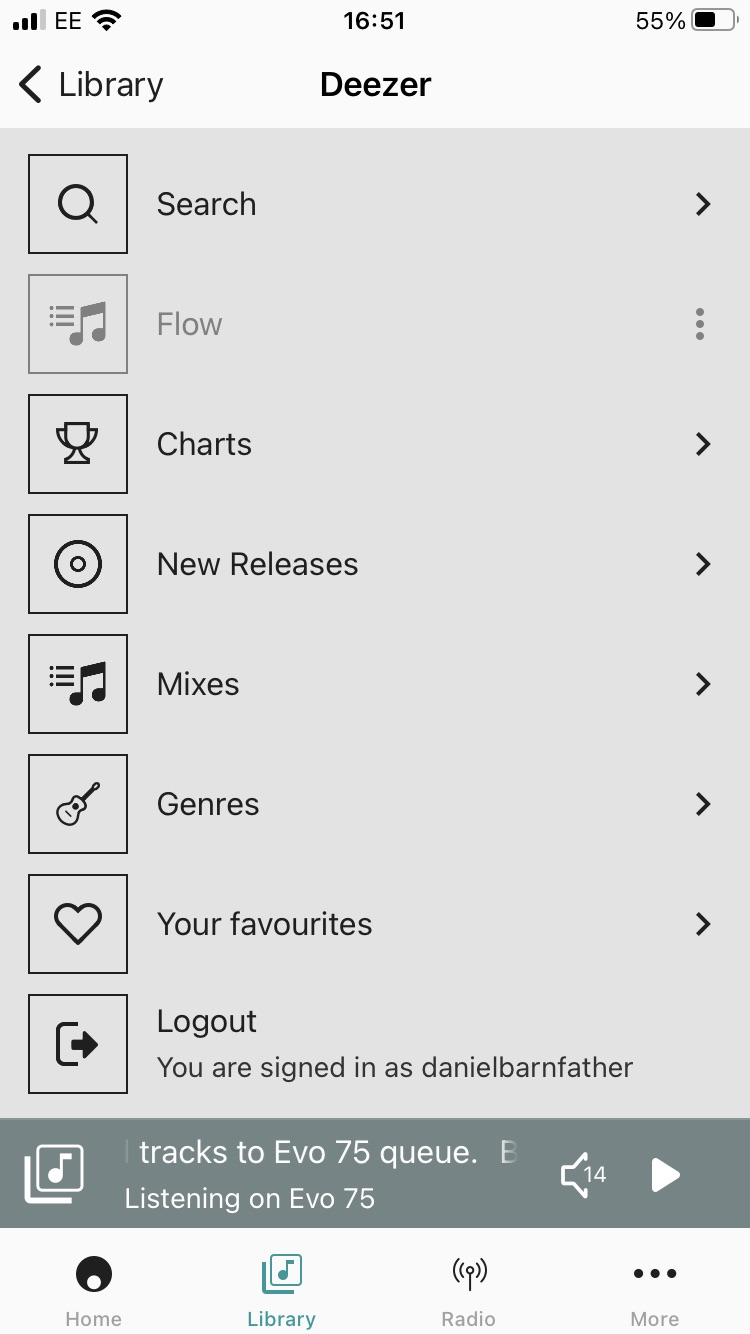

6. Select the chosen content you want to stream to your Network Player. Deezer should now be streaming to your Network Player.
