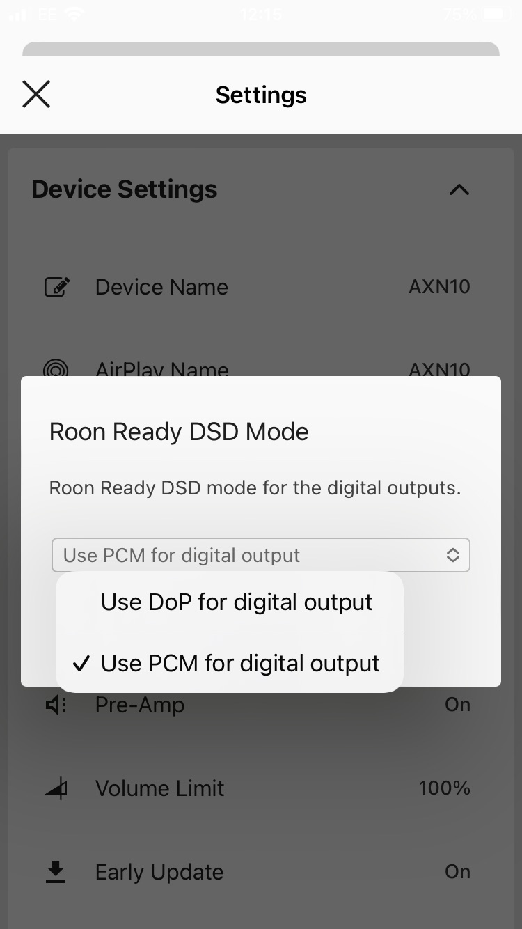

1. Navigate to the device settings of your AXN/MXN within the StreamMagic app
2. Select ’Roon Ready DSD Mode’
- Then select ‘Use PCM for digital output’
Note: This step is required as Roon’s DSP volume control does not support Native DSD
playback.

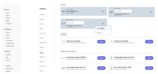

3. Within Roon’s audio settings, select the ‘Cog’ icon next to your AXN/MXN, and select ‘Device Setup’
4. Select ‘Device volume’ via the Volume control settings and then select ‘Save’
5. You will now be able to control the volume of the AXN/MXN via Roon’s own volume control
