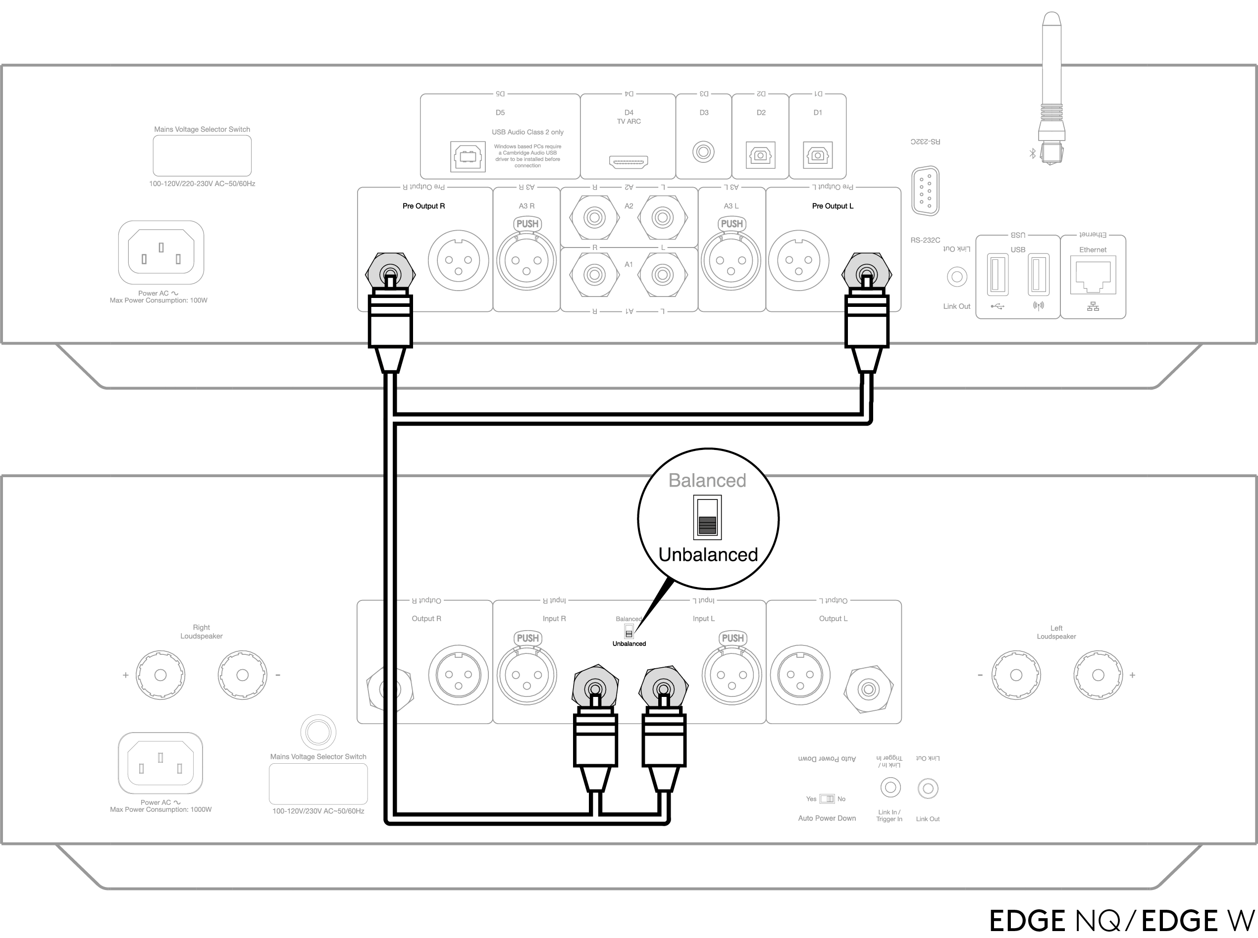

Please see below for diagrams on how to make either a balanced or unbalanced connection from your EDGE NQ to your EDGE W.
Using either of these analog connections will ensure you make use of the high-quality DAC within the EDGE NQ.
Unbalanced
Using RCA cables will enable an unbalanced analog connection to your EDGE W. RCA cables are very convenient and fairly cheap, whilst still providing excellent quality.
If using RCA cables, please ensure to select the ‘Unbalanced’ switch on your EDGE W.
