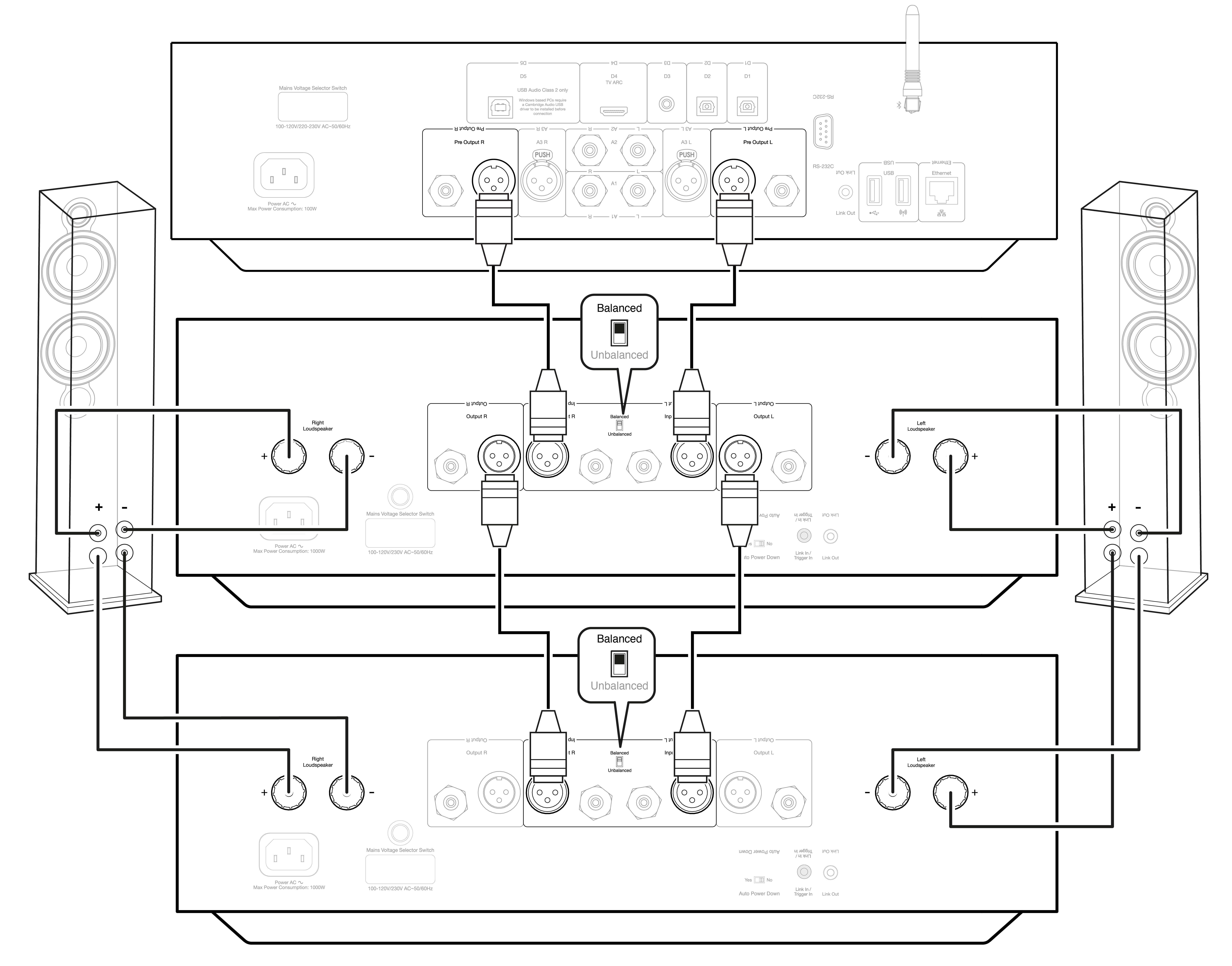

Bi-amping allows you to drive the high and mid frequencies of your speakers from one power amp, and the low frequencies of your speakers from a second power amp.
The benefits of bi-amping include a fuller sound with added bass and treble clarity.
Please see below for a diagram on how to bi-amp a pair of EDGE W's connected to an EDGE NQ using a balanced connection.
