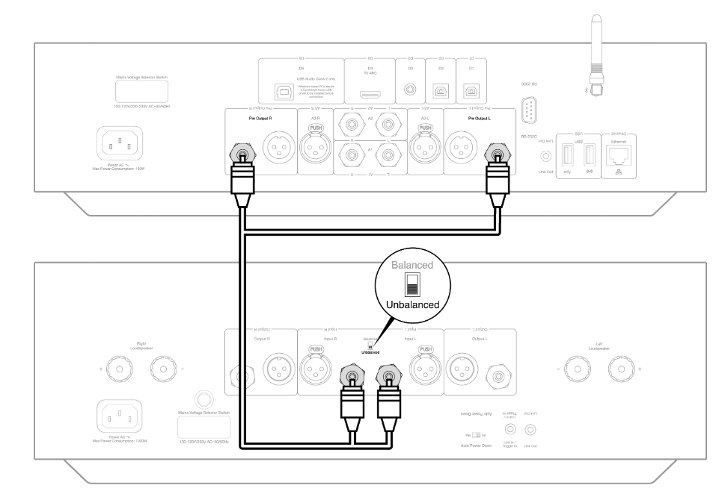

Unbalanced input
Using RCA cables will enable an unbalanced analog connection to your EDGE W.
If using RCA cables, ensure the ‘Unbalanced’ switch on your EDGE W is selected.

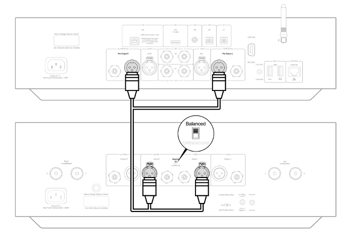

Balanced input
Using XLR cables will enable a balanced analog connection to your EDGE W. This will provide a cleaner signal path compared to an RCA unbalanced connection, especially over longer cable lengths, however, the increase in audio quality they provide is subjective when used over shorter lengths.
If using XLR cables, ensure the ‘Balanced’ switch on your EDGE W is selected.
