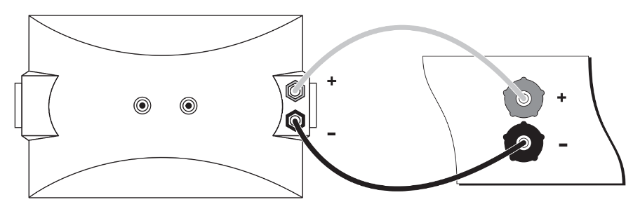

2. With your amplifier turned off, connect the speaker using the terminals located on the rear panel
Please ensure that you match the polarity of each connection between speaker and amplifier.

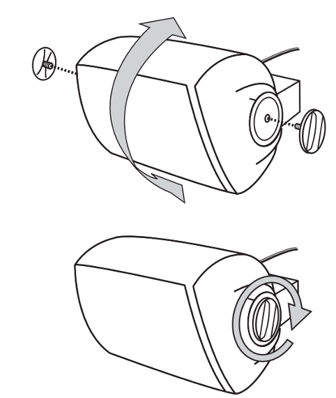

3. Loosely fit the speaker to the mounting bracket and adjust it to your desired position
We would recommend angling the speaker downwards slightly to minimize direct exposure to the elements. Once you’re happy with the positioning, tighten the two knobs to secure the speaker.
