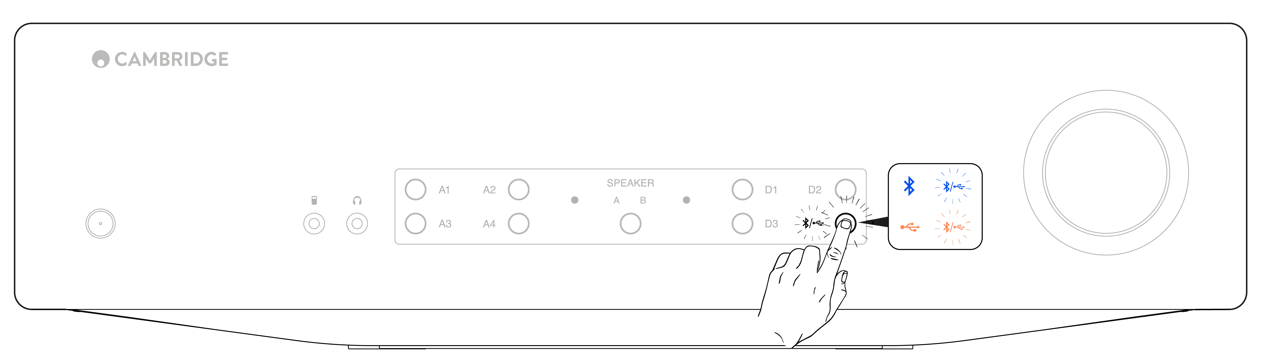

2. Ensure that the Bluetooth source has been selected by selecting the Bluetooth/USB Audio button on the front panel
The Bluetooth source is shown by the symbol being lit blue. When the USB source is active the LED will be orange.

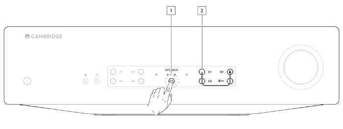

5. Perform a factory reset on the CXA:
- Whilst the CXA is in standby mode, press and hold the speaker A/B button.
- Then when the A/B lights flash, press D1, D3, USB, D2 in a U shape sequence
