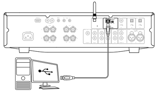

1. With the CXA in Standby mode and/or the volume set to minimum, connect your PC to the CXA via a USB A to B cable
2. For the highest quality playback, ensure that the CXA is set to USB 2.0 mode
