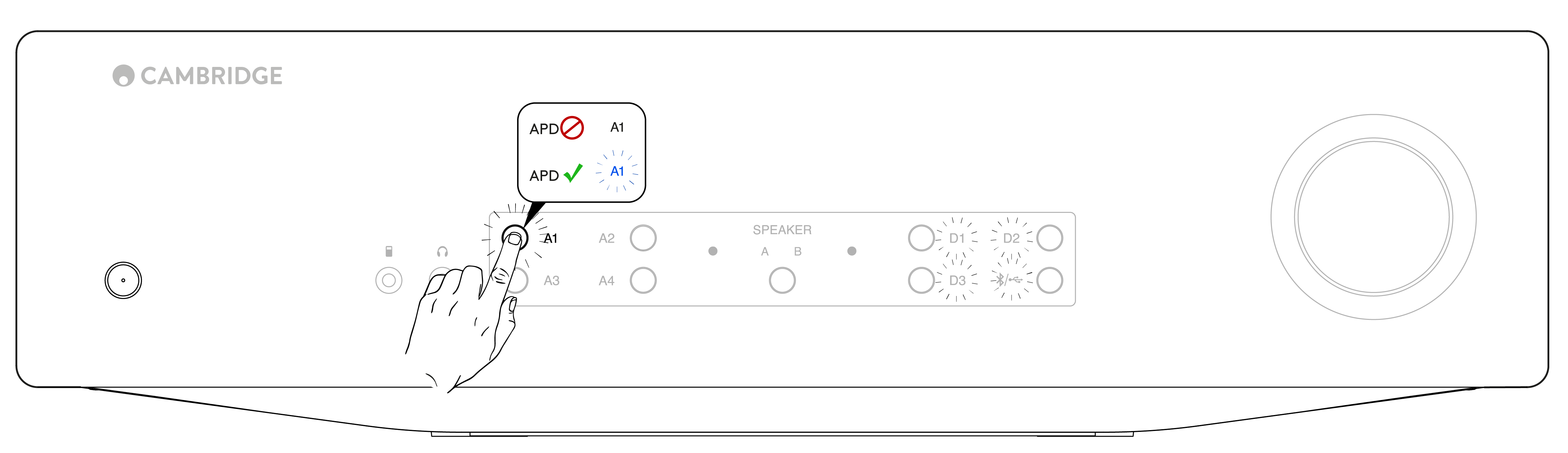

If you wish to disable the APD function on your CXA amplifier, please follow the instructions:
With the unit in standby, press and hold the Speaker A/B button until the A and B lights flash and the sources A1-A4 light up.
Press the corresponding button configuration for your choice of setting:
- A1 off – Disables the APD function.
- A1 on – Sets the APD time to 20 minutes.
Please note: The selected button is represented by blue light.
