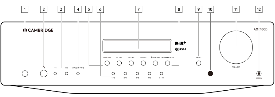

2. Insert the USB drive into the service port on the rear of the unit
3. Insert the power cable and switch on the unit
4. Enter the menu by pressing the menu key (9)
5. Using the volume control, navigate to ‘Upgrade’, pressing the volume control to enter, then ‘MCU upgrade’, then ‘Yes’
The unit will then automatically detect the file on the USB drive and update automatically. The unit will then switch off. (If ‘No File’ message is displayed then restart at Step 1)
6. Switch the unit on
7. Press the DAB key, then MODE/STORE (4) key 3 times to navigate to ‘Auto-Scan’
8. Press the NEXT key (3) to restart auto-scan procedure
