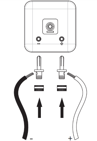

1. Ensuring to match the polarity/colour coding, connect the supplied speaker terminals to the speaker outputs of your amplifier by unscrewing the ends, and securing the speaker cable in the available hole on each terminal
These terminals can then be installed into the rear of the MIN12 with the cables connected.

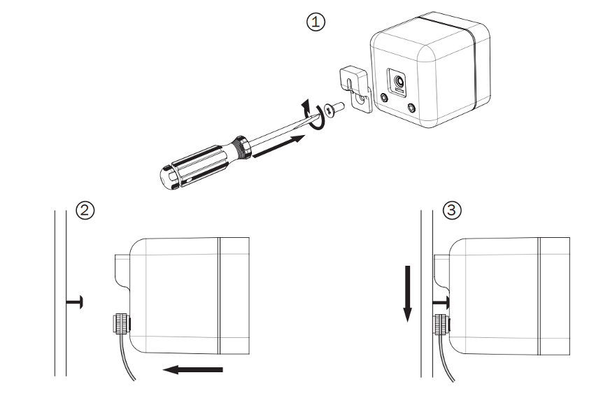

2. If mounting the MIN12 speakers to a wall you will need to attach the included keyhole bracket using the mounting screw to the rear of the speaker
3. Alternatively, we offer several other mounting solutions including a pivoting wall mount, desk stand, and floor stand.
