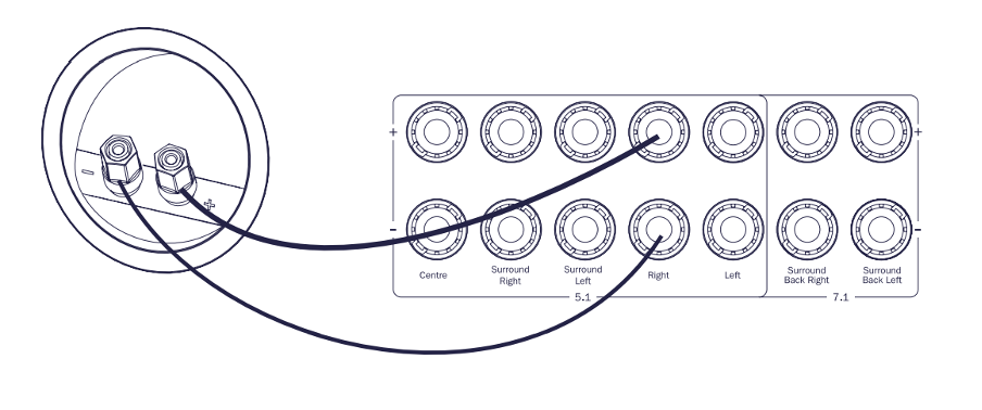

1. Using high-quality speaker cable connect the SX-80 floor-standing speakers to the speaker terminals on your amplifier
Ensure that you pay close attention to match the polarity of each connection.

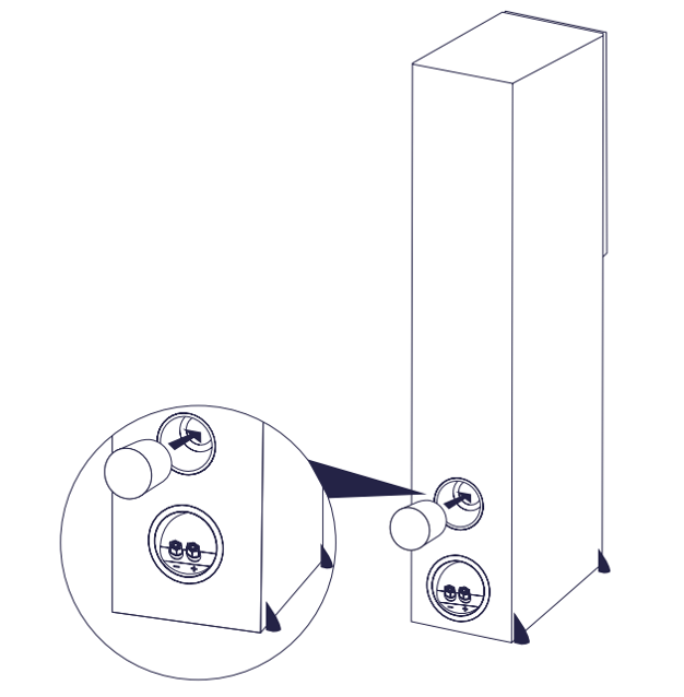

2. If placed close to a wall you may benefit from using the included foam bass tuning bungs
These can be placed into the rear port of each speaker to reduce the low-frequency output.

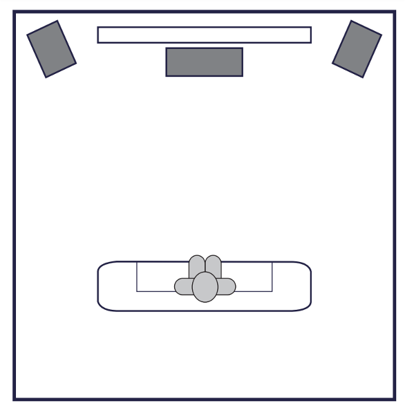

3. When positioning, we would suggest that the distance between speakers and the listening position is equal
However, we would encourage experimentation until you find a solution that works for your space.
