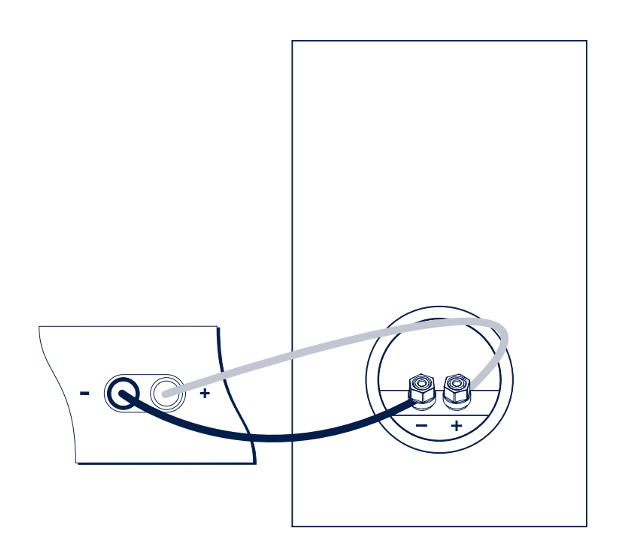

1. Using high-quality speaker cable connect the SX-60 stand mount speakers to the speaker terminals on your amplifier
Ensure that you pay close attention to match the polarity of each connection.

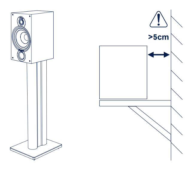

2. For the best results we would recommend using speaker stands to mount your SX-60 speakers
Alternatively, the speakers can be placed on a shelf, and in either case we would suggest leaving at least a 5cm space behind the rear of each speaker.

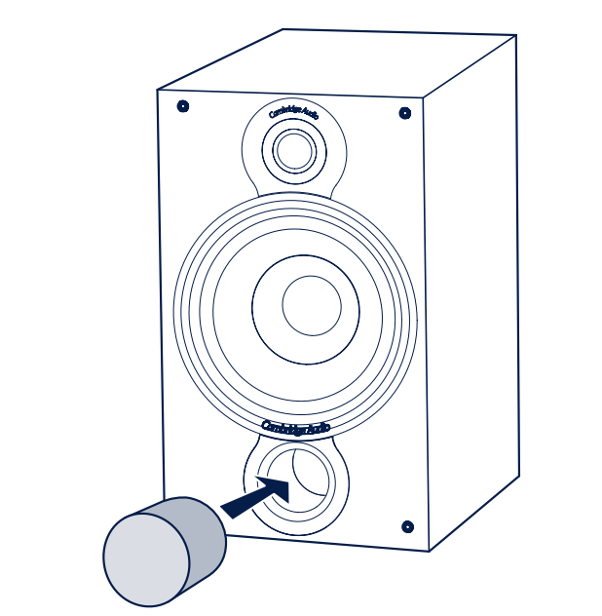

3. If placed on a desk, or close to a wall you may benefit from using the included foam bass tuning bungs
These can be placed into the rear port of each speaker to reduce the low-frequency output.

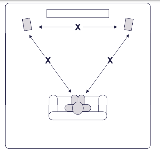

4. When positioning, we would suggest that the distance between speakers and the listening position is equal
However, we would encourage experimentation until you find a solution that works for your space.
