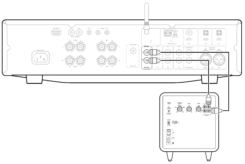

1. If you are using a two-channel hi-fi system, then use the left and right line input connections to connect your Minx X301

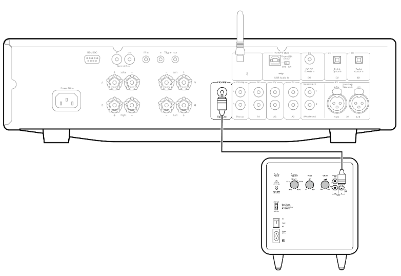

2. If you are using a receiver, or amplifier with a dedicated sub out then connect the Minx X301 using the left channel (LFE/Sub) input

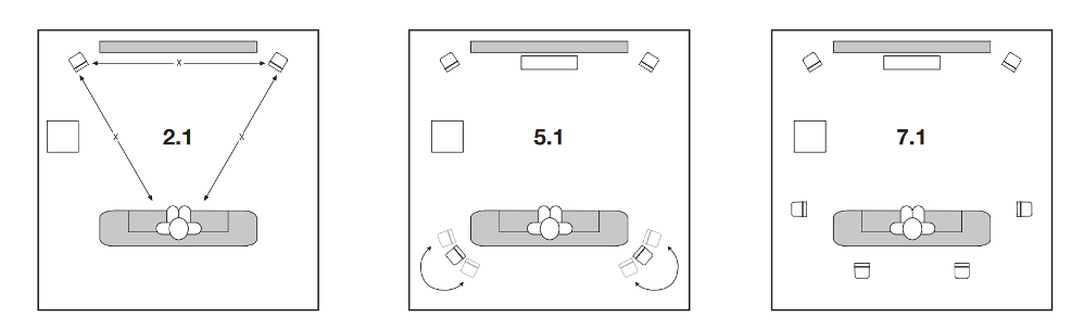

3. Once connected you can decide where to position your subwoofer
As low-frequency content is largely unidirectional, you can experiment to find a place that suits your setup. Please see the below diagram for several suggestions on placement dependent on your speaker configuration.
