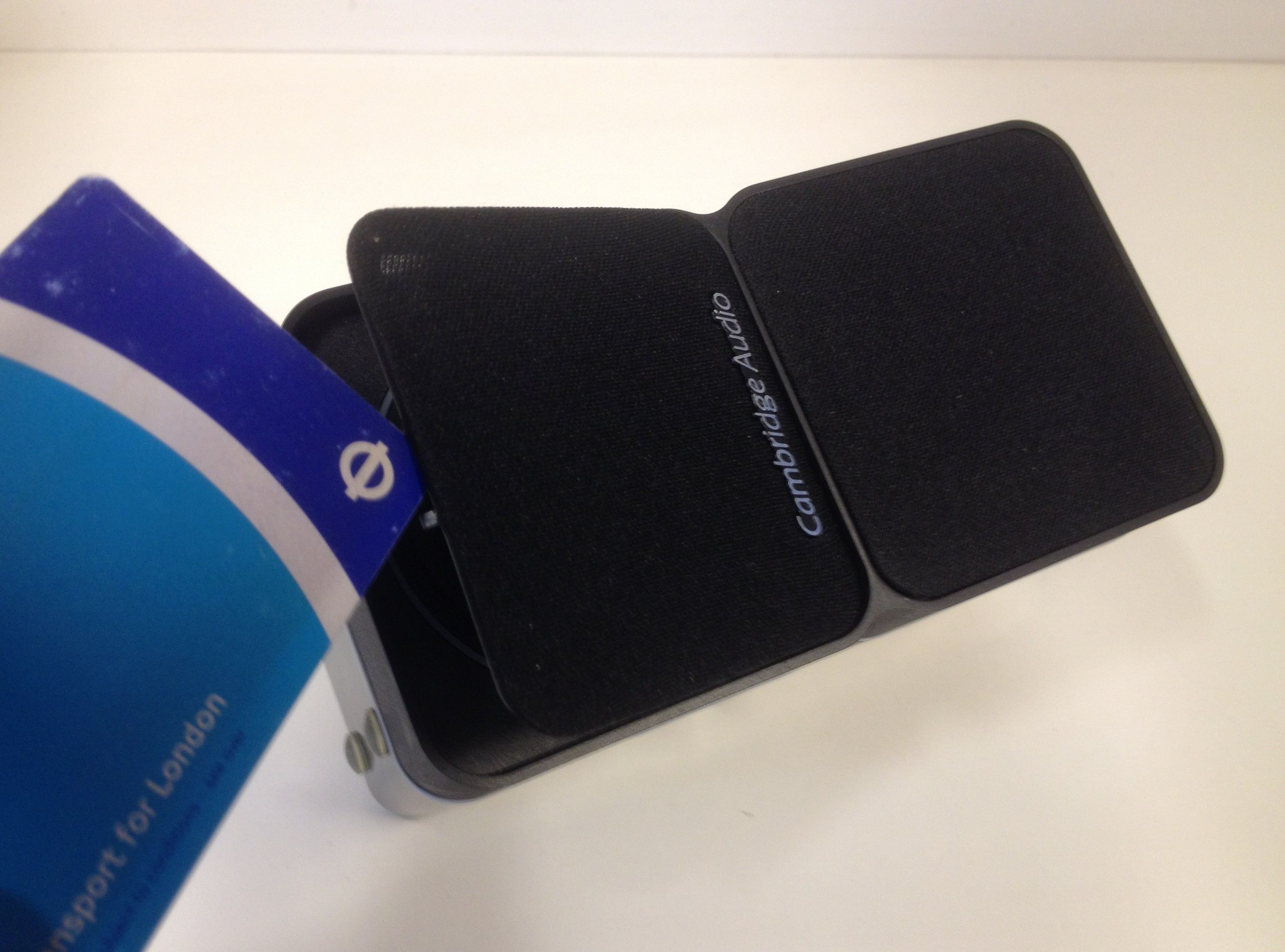

To remove and rotate the grille of your MINX speaker, simply insert the edge of a credit card or a similar object into the gap between the grille's outer edge and the speaker. Gently pry the grille away from the speaker.
Rotate the grille as desired and press it back onto the speaker. It will click once seated in place.
